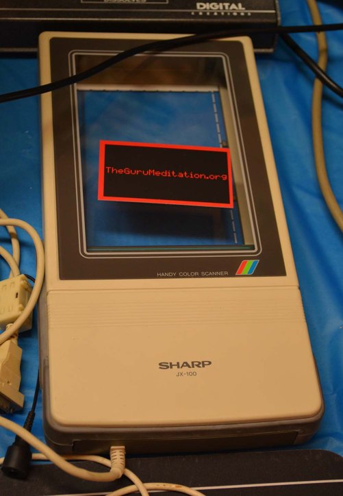

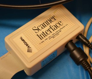

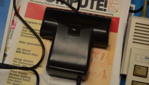

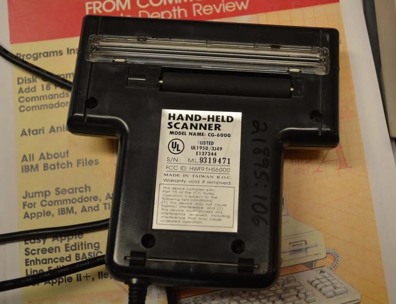

These handheld scanners had a single linear CCD and a small ‘one dimensional mouse’ on the underside of the scanner. Open up the included software, drag the scanner across an image, and eventually an image will appear on the screen. These handheld scanners rarely worked well, and for some reason the image produced from this scanner was ‘squished’. If you needed images in the early 90s, you could step up to a flatbed scanner. [Bill] and [Anthony] had the smallest and cutest flatbed scanner I’ve ever seen, a Sharp JX-100. This scanner also delivered color images over a serial connection. In 1990, this scanner cost $700.

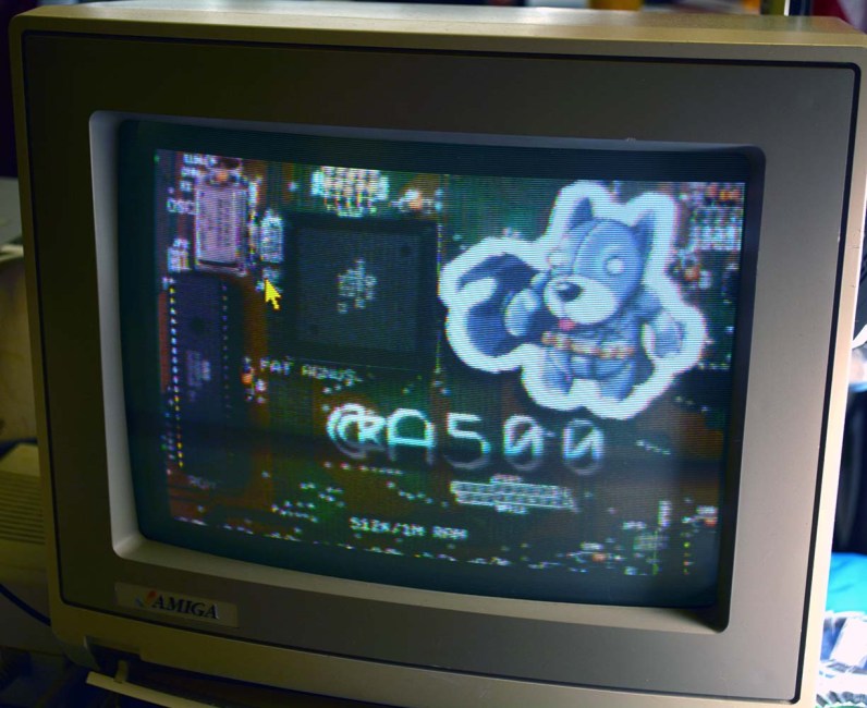

There’s more than one way to skin a cat, and if you didn’t have a scanner, you could take a picture instead. Consumer digital cameras were terrible, but that didn’t mean you couldn’t find a cheap TV camera and digitize the output. That’s what [Anthony] and [Bill] did, using a black and white security camera to take color images of an Amiga 500 board.
How does a black and white camera produce color images? With a color wheel, of course. [Bill] and [Anthony] brought out a piece of kit built by NewTek, creators of the Video Toaster, that’s basically a black and white camera with a color wheel controlled by a servo. By taking three pictures through red, green, and blue color filters this Amiga 1200 can take full color images. Sure, the resolution is only as good as standard definition TV, but if you need images on your Amiga, this is the cheapest way to go about it. The entire setup, sans Amiga, cost $200 when it was released.

  4. Handheld scanners aren’t exactly bad. You just need a steady hand. A flatbed scanner is basically moving the scanner for you, mechanically. There were scanners made to replace the printer head of a dot matrix printer (ImageWriter?) and let the printer scroll the paper for a more accurate scan.
    1. Yeah, I had one for a while and it worked pretty well. As long as you did not go to fast they worked well and you could do some pretty funny stuff my moving them how they were not supposed to be moved.
