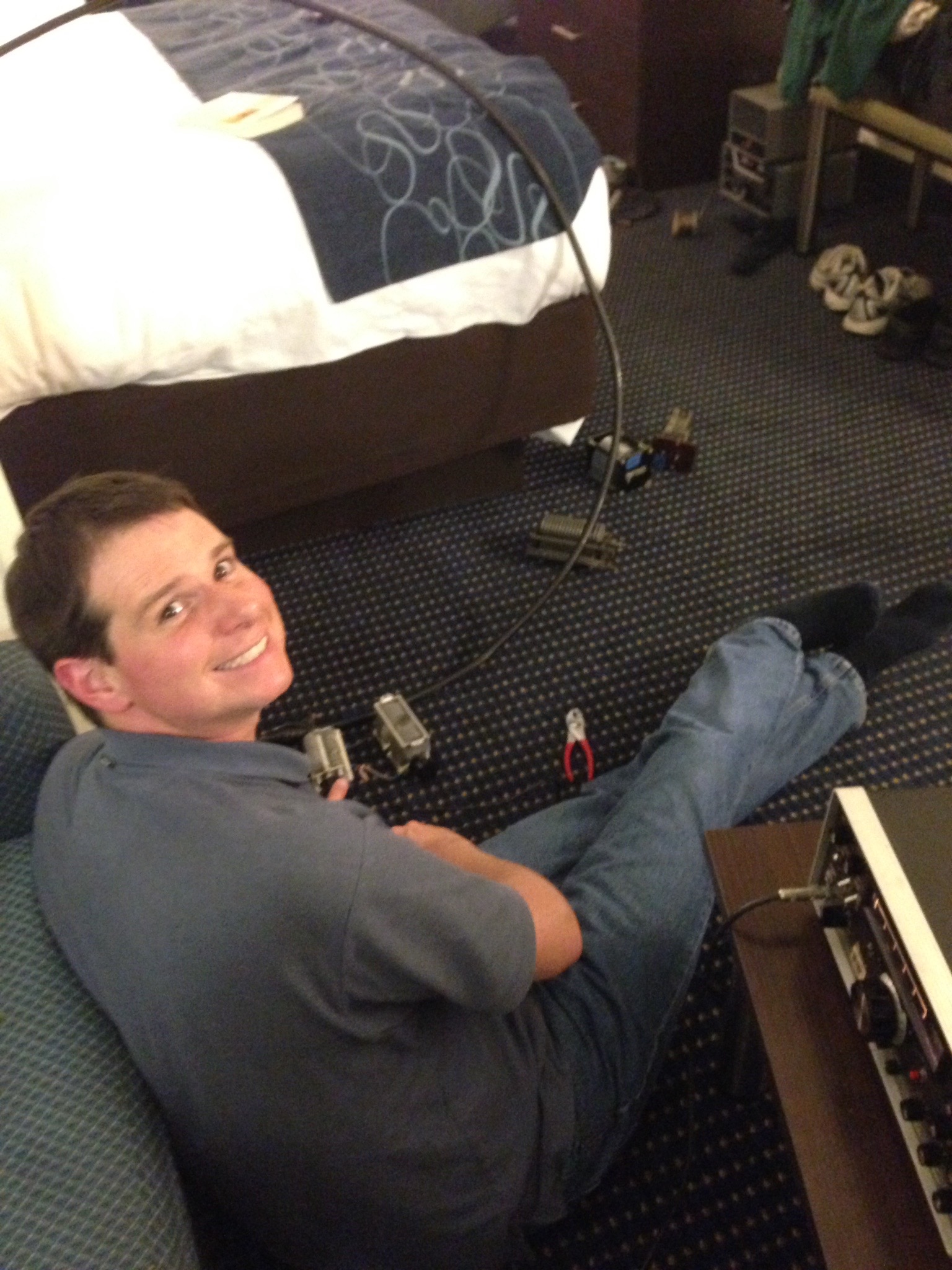

How do you make a decent indoor antenna that would work within a concrete structure? The magnetic loop seemed like a good option. A mag loop works on the magnetic field component of the electromagnetic field. Mag loops are used in almost all AM broadcast radios and often used by radio amateurs in Western Europe where space is at a premium. Unfortunately they’re not too efficient.
Efficiency depends on the ohmic losses in the mag loop conductors at your operational wavelength.  Furthermore, the directivity (antenna gain is the product of directivity and efficiency) of a mag loop is usually poor due to the small physical aperture of the loop. For best performance we want to make the loop as big as we could reasonably fit in the hotel room and also use the thickest-available cable or wire for the loop itself.

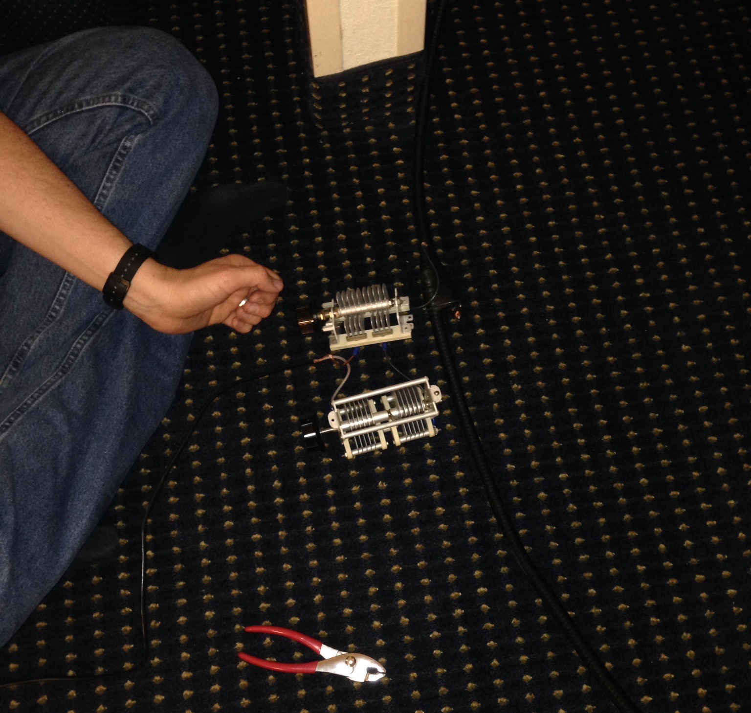

After failing to get a 4′ loop of RG58 working on Friday night I was on the lookout Saturday for a replacement. For $10 a length of ¾” hardline or heliax coax cable (a very large industrial coax), larger gauge hook-up wire, and some terminal lugs were procured. Now we had everything needed to make a serious mag loop.
Rzather than an inductive coupling we decided to use capacitive coupling.  One variable cap for resonating the loop and a second in series for coupling.  We used short lengths of #14 wire and terminal lugs back-filled with solder to wire it up.
After peaking both caps for maximum receiver noise the loop tuned up well at low transmit power, easily achieving less than 1.5:1 SWR.  I did notice that the loop de-tuned when I touched the feed coax.  Because of this I rolled a shunt balun with 10 turns of RG58 directly in front of the coupling capacitor. Hand capacitance problem solved, SWR was well behaved, the loop was now being fed with a balanced line.
Time to get on the air.  We turned up the power on the Omni-A and keyed the radio. Unfortunately it did not seem like we were transmitting 100 watts. The lights were not flickering in the hotel room or even on the radio itself. Nothing in this radio/antenna system seemed like it was trying to transmit.  The output power meter on the radio read flat, one or two watts.
We did confirm good SSB transmit audio with the Hammurland, so something was getting out but not much. After goofing around for a while with the OmniA is seemed like it was a transmitter problem within the radio. As a last ditch effort the Omni-A’s manual was consulted (isn’t that alwasy the way?).
Automatic Level Control (ALC) is kind of like an automatic gain control (AGC) for a receiver except that it is used for transmit.  With this you can achieve a higher average power than transmitting a simple linear voice SSB signal. ALC is something I have not incorporated into my own radios that I’ve built.  Stupidly enough and not being at all familiar with the Omni-A we had left the ALC control at 0. Who has time to read the manual anyway?
We turned it up to about 3/4 clockwise, whatever that meant.  The transmitter kicked on strong.  Lights in the hotel lights dimmed to the SSB carrier, power meter on the radio read a solid 75+ watts. The Omni A worked after being neglected for decades, what a tough radio!
Electrical Fire
Time to get on the air.  Scott was performing some ‘Check 1 2 3 4 tests’ at full power when I observed a very bright arc near the tuning network.  To be sure I asked Scott to try again, I observed something near the mag loop’s coupling capacitor that appeared to be breathing fire in proportion to his voice.
The tuning network was made up of two very large and old variable caps, these were large WW2 surplus variable caps, one of which used ceramic insulators and the other was made of slate. These should be able to handle the RF current and voltages. These caps and the associated wiring were laying on the carpeted floor at the base of the loop which was propped up against the hotel bed.
IMG_3149
Omni A back on the air!
I had used very short lengths of #14 wire to tie the network together.  The insulation break-down voltage was rated for 600V.  This is standard stuff you could get at the local hardware store. I asked Scott to key the radio again, while I observed the tuning network and there it was! A solid arc. Wow it was a sight. Do it again! Another arc. On the third try something lit on fire. Smoke filled the room.
It was easily put out but the smoke was nasty. We cleared it out of the room and luckily did not set off the smoke alarms. Upon inspecting the tuning network wiring it seems that the insulation had broken down and burned on the cheap #14 wiring. To fix this, I re-adjusted the wiring to put more space between the wires and placed a hotel ice cube tray under the network for added insulation. We were back on the air without further trouble.
