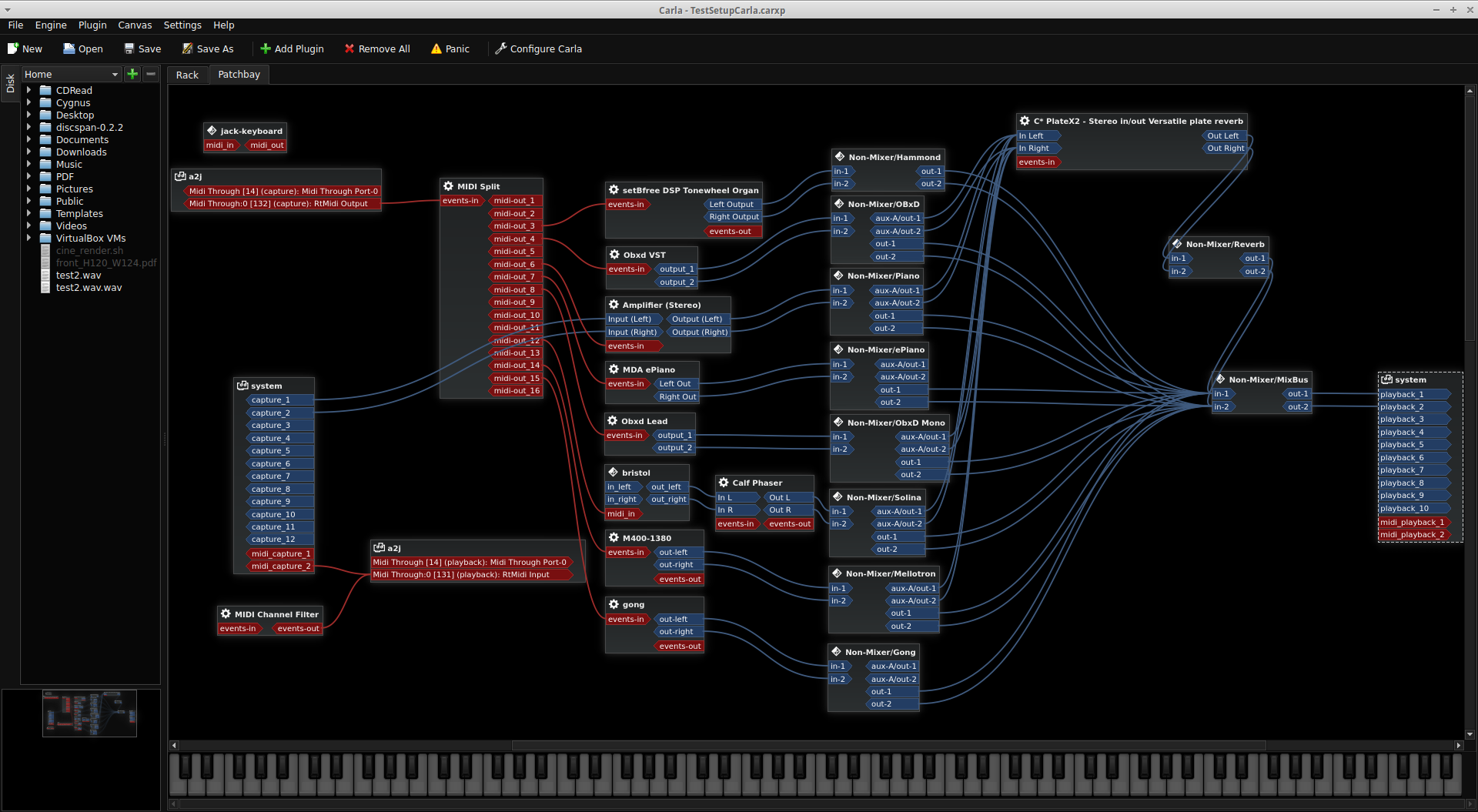

    2. Reaper (I’m a registered user) is a wonderful piece of software written by top notch programmers and musicians, however it lacks a bit in how to arrange connections between effects easily in an understandable way. Its matrix allows any possible connection, but for everyday use I find the graphical approach of other apps much more immediate.
      Reaper matrix:
      http://i56.tinypic.com/10z36ee.jpg
      Carla (a Linux host):
      http://www.etcetera-music.eu/public/instruments/LinuxMusic/Carla.png
