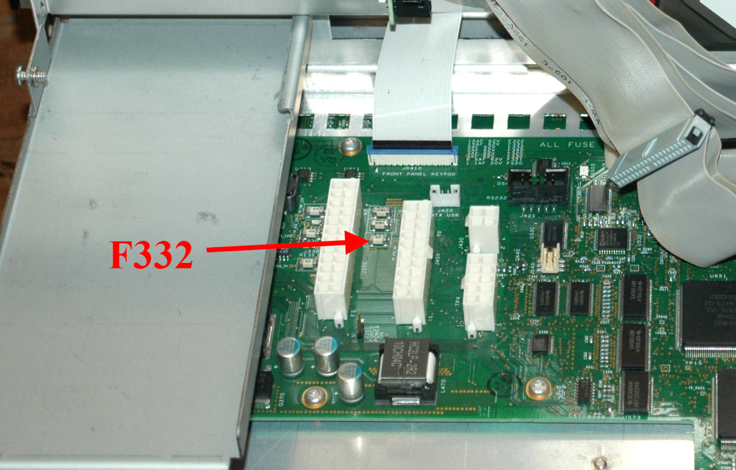

[Matthew] found that Tektronix’s portion of the electronics took the ravages of time and classroom use quite well, only the embedded desktop PCs inside the machines simply weren’t built for the ten-year. Some of the hard-drives had to be replaced, but most units wouldn’t even make it to the power-on self-test (POST). A closer inspection of the generic Intel microATX motherboards quickly revealed that some of the e-caps already bit the dust, leaving behind a spill of leaked electrolyte and a blown SMD fuse. Replacing both restored functionality on these boards.

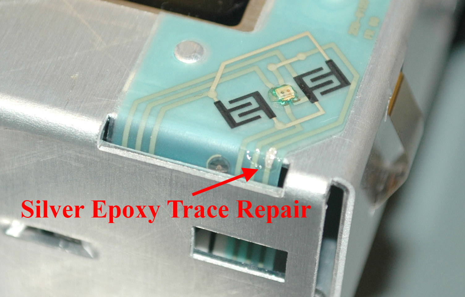

The sweet victory of repairing a piece of top-notch equipment is not always so close. In one of the analyzers, the mainboard couldn’t be fixed, it had to be replaced. [Matthew] was able to source an identical board, to which he transplanted the logic analyzer’s customized BIOS IC. Another analyzer was plagued with a dim power indicator LED, caused by a cracked trace in the flexible silver-ink PCB it was mounted to. A drop of silver epoxy and a bit of superglue solved the problem.
