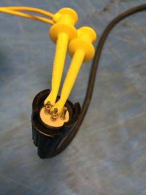

On occasion I have encountered portable soldering irons and my impressions of them have ranged from nearly usable to total rubbish. While using a popular butane powered model and pondering if it was really any better than a copper wire and a candle a thought occurred to me. A regular old Weller station runs on 24 volts AC and performs all of its temperature regulation in a magnetically activated thermostatic fashion and all of that goodness occurs within the hand piece itself. It stood to reason that it could perform just as well with a DC source.
In this instance we are ignoring the negative effects of switching DC current over AC current on mechanical contacts. After all we are “In the Trenches” wherever we might have need for such a device. Using a couple of gel cell 12 volt 7 amp hour batteries freshly removed from a UPS I strung them up, and there you have it, a totally battery operated iron with performance equal to that of the one at my bench.
Right at 24 volts the iron Thermocycles at the same rate as it would be while using the bench top supply for it. Just sitting under no load it cycles about every ten seconds and there was no perceptible difference in heat capacity or performance. A fully charged pair of batteries will last all day. The on state current draw from a full charge (13.5 volts on each of the batteries) yielded about a 2 amp draw. As the voltage began to decrease the current off cycle would get shorter as one would expect, but no drop in heat transfer was noticed until the batteries were well depleted and that took most of a work day.
For this instance I used the hand piece from the venerable Weller WTCPT station. For ongoing use I would not recommend this due to the use of a mechanical contact within the unit and switching of DC can reduced the life of most mechanical switches. Currently I am awaiting the arrival of some cheap eBay Hakko handpieces; I am sure they are knockoffs, but fine to experiment with a simple PWM with a feedback loop controller as the basic Hakko design also utilizes a 24 volt source. An automatic shut off timer would also be handy to avoid premature battery abuse due to a forgetful operator.
I’ve thought about replacing the heavy transformer/stand with a little 40W, 24V switching wall-wart so the whole thing would be easy to just throw in a bag or tool box. Just re-terminate the end with a standard DC Barrel Jack.

This is why I am looking forward to trying it with a Hakko type iron.
If the HAAKO is electronically switching AC it’s most likely using a zero crossing SSR which won’t work for DC power because it will never turn off. We use zero crossing SSRs in our mash controllers and boil controllers. Tom
As a matter of fact it does switch the AC current. I will build a suitable controller for DC use. They heating element wont care if its being fed by AC or DC.
If you use an H-bridge you can also correct the DC related problems by providing both a zero switching point and evening out the applied magnetic field.

Neat idea!
However I have doubts about the current handling capabilities of those grabber hooks.
3 amps for Minigrabbers. I have used them up to 5 amps and they have not melted. Not recommended though.
http://www.pomonaelectronics.com/pdf/d4233_100.pdf
Oh, number soup. the micro grabbers are 3 amp. the mini grabber (used in these jumpers) is 5 amps
http://www.pomonaelectronics.com/pdf/d3925_k4176_k5522_1_01.pdf
sorry.
That’s some damn good documentation. Pomona FTW
I’d highly recommend their “test lead wire” Really flexible and high current stuff.
