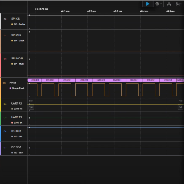

The Saleae logic analyzer software is shown. One PWM channel is active, with values of 0x0001 displayed above the individual waveforms. On the right panel of the app, a trigger mode configuration panel is open for the simple parallel analyzer.
Saleae logic analyzers seem to have it all: good sampling rates, convenient protocol decoding, and plenty of channels – but not a good way to set rising or falling-edge triggering. [James] found this rather inconvenient when debugging embedded devices, and shared a workaround that replicates these simple triggering modes.
Crucially, the logic analyzer’s software has a repeated triggering mode that fires when the protocol decoder detects a preset value. [James] used a clever trick to turn this into a rising-edge trigger: he set up a simple parallel analyzer, and set the signal in question as both the sampled channel and the clock signal. Since he wanted to detect the rising edge, he set the clock mode accordingly. Next, he loaded the simple parallel decoder’s trigger configuration and set it to detect a value of one, the value of a high signal. When he ran the simple parallel trigger, every rising edge of the input signal would trigger the clock to check for a high value on the line, in turn triggering the analyzer.
It’s also possible to set up a falling-edge trigger by selecting the falling-edge clock mode and setting the trigger mode to detect a value of zero. Setting up more complex triggers involving multiple channels is as simple as calculating the hexadecimal value of the desired state and setting the parallel decoder to trigger on that value. For example, if you want to trigger when one input is low and another is high, you can set the decoder to trigger on a value or one or two, depending on which order the inputs come in.

  1. The article summary here is a bit confusing – the video in question is a workaround to replicate the “normal” trigger setting of an oscilloscope, where it will capture and replace the existing capture on screen (usually with some level of persistence) whenever a new trigger is detected.
    The summary makes it sound like the Saleae software doesn’t support falling edge or rising edge triggers even in the equivalent of a scope’s single/one-shot mode – which is of course table-stakes and nobody would enjoy using a logic analyzer that didn’t support that.
  2. You can also just use Sigrok / Pulseview. Their website is back up again. In pulseview you can simply select any channel for either rising, falling or toggling trigger. (And a static level for other channels). And the data captured in the video above can be done for 1% of the cost of the saleaeae thing. Salesaleaea more then doubled the price of their hardware in a few year some time ago, and they stopped selling the “low cost” / entry level hardware altogether. The analog channels of the SaleSaleSale are nice but their lowest cost gadget costs more then my Siglent SDS1104X-E. But SaleSaleSale does manage to keep their head above the mowing field. There were other companies who started similarly (such as USBee) and they nearly all collapsed.
