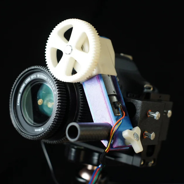

When you watch a movie and see those perfect focus switches or zooms, the chances are you’re not seeing the result of the cameraman or focus operator manually moving the lens controls. Instead, they will have been planned and programmed in advance and executed by a motor. If you take a close look at many lenses you’ll see a ring that’s more than just extra knurling, it’s a gear wheel for this purpose. Want to experiment with this technique without buying professional grade accessories? [l0u0k0e] has you covered with a 3D printable focus zoom motor accessory.
The motor behind it all is a geared stepper motor, and there are a set of printed parts to complete the model. It’s recommended to use PETG, and nylon for the gears, but it would work in PLA with a shorter life. It’s designed to work with the standard 15 mm tube you’ll find on many camera rigs, and while you can write your own Arduino sketches to control it if you wish, we’re given instructions for hooking it up to existing focus drivers. The model is on Printables, should you wish to try.

  3. I don’t get what people have with these large spur gears when one can achieve far less stick-out using bevel gears and a pancake stepper motor underneath the lens, with a miniature bearing pushing up against he back side of the bevel gear collar and the ability to attach the motor plate to the tripod mount.
        1. Really not sure how bevel gears would be any advantage here. I have two professional versions that add less than 15 mm to one side of the 90 and 100 mm diameter lenses, and have no bevel gears… All three motor axes of each one are parallel to the lens axis. (The three motors control aperture, zoom, and focus).
          1. I thought that’d be self-explanatory. One can reduce the pressure angle below 20°, but the pressure line still won’t be tangential. So at least dynamically there will be a radial force component pushing a spur ring gear sideways. The switch from spur to bevel ring gears rotates the force direction by 70° to 90°, allowing the ring gear to be pinched between bevel pinion and a miniature ball bearing.
            Granted, this still requires the lens to counteract a tangential force vector, but you can 3D print the bevel gear variant and get away with a flimsy construction that could bend and let spur gears skip.
          2. First you state that bevel gears have the advantage of “far less stick-out”. Then when challenged with a commercial counterexample you pivot and say that actually the advantage is the pressure angle is in a different direction.
          3. Paul, you’re not challenging anything here. I knew right at “The published design uses bevel gears.” that you were going to be annoying, but I played along. Don’t like a comment, don’t engage with it. My proposed design still delivers lower stick-out if you leverage that, but you seemed not to get the kind of geometry that was implied.
