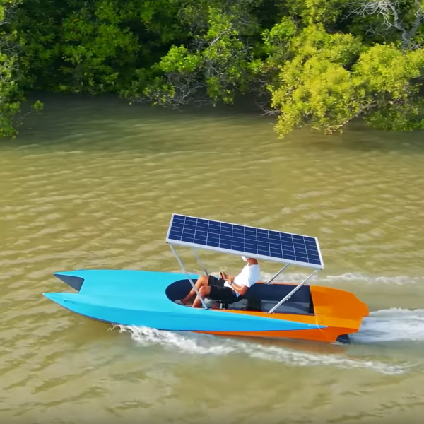

Electric cars are everywhere these days, but what about boats? Looking to go green on the water, [NASAT] put together this impressively nimble boat propelled by a pair of brushless motors.
The boat itself has a completely custom-built hull, using plywood as a mold for the ultimate fiberglass body. It’s a catamaran-like shape that seems to allow it to get on plane fairly easily, increasing its ultimate speed compared to a displacement hull. It gets up to that speed with two electric motors totaling 4 kW, mated to a belt-driven drivetrain spinning a fairly standard prop. Power is provided by a large battery, and the solar panel at the top can provide not only shade for the operator, but 300 W to charge the battery when the motors are not being used.
With the finishing touches put on, the small single-seat boat effortlessly powers around the water with many of the same benefits of an electric car: low noise, low pollution, a quiet ride, and a surprisingly quick feel. Electrification has come for other boats as well, like this sailing catamaran converted to electric-only. Even some commercial boats have begun to take the plunge.

  1. I don’t think I’ve seen anyone run two motors in parallel from a single ESC before. I’m rather surprised that works at all since the ESC needs to sense back EMF from the motor to know when to switch.
    1. Depends on the ESC. Some have quadratic and/or three phase Hall inputs. If one motor is controlled and the other is just rolling along, they will eventually align by slippage and start working together. If it’s a toothed belt, you have to time them to stop the motors fighting each other.

    Not a very large battery — I wonder how long it can sustain 4 kW. Certainly not more than 15 minutes.
    I wonder how fast it can really go?
    Not likely to confused with boats from the other Electric Boat Company, which do (at least) 25 knots for weeks, but they cost a bit more.
    1. You often stay on a plane for more than 15 minutes?? On inland lakes that’s often enough to do several laps around!
      This looks great for a very common kind of lake people. Plane from shore to an island for quick runs back and forth, using battery. Putter around at displacement speeds for sightseeing or just enjoying nature, using roughly the same power as the solar panel is producing. Swing into the fishing hole and drop a line while the batteries silently recharge.
      Yeah, I’d use this. I’d use the heck out of this. I’ve pondered building exactly this minus the planing capability because I didn’t consider it within reach. Time to recalculate!
