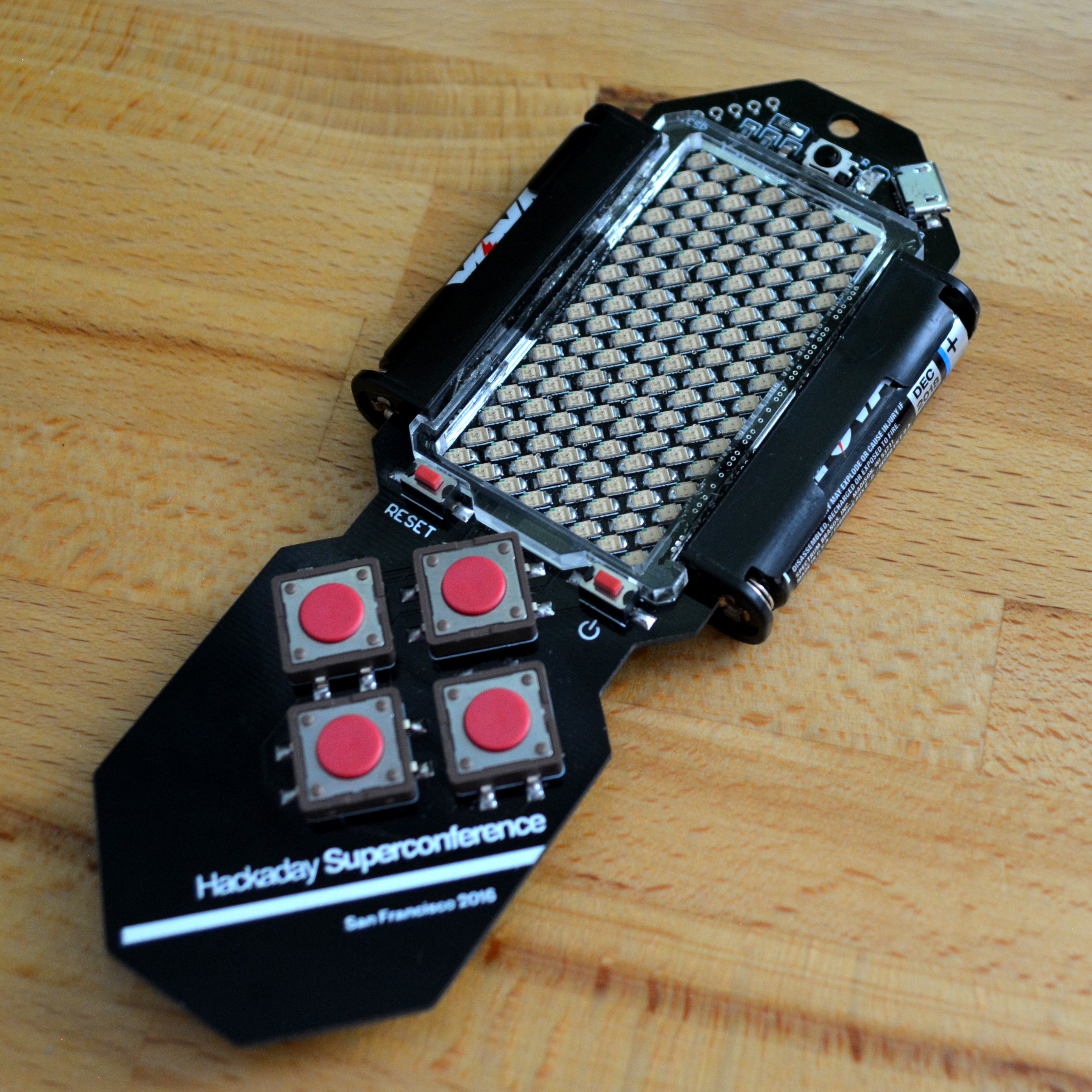

This badge hosts an 8×16 surface-mount LED matrix, four user buttons (plus reset and wake-from sleep), IR communications, and a three-axis accelerometer, all driven by a PIC18LF25K50, powered by two AAA batteries, and programmed via USB. That’s a mouthful of delightful hardware.

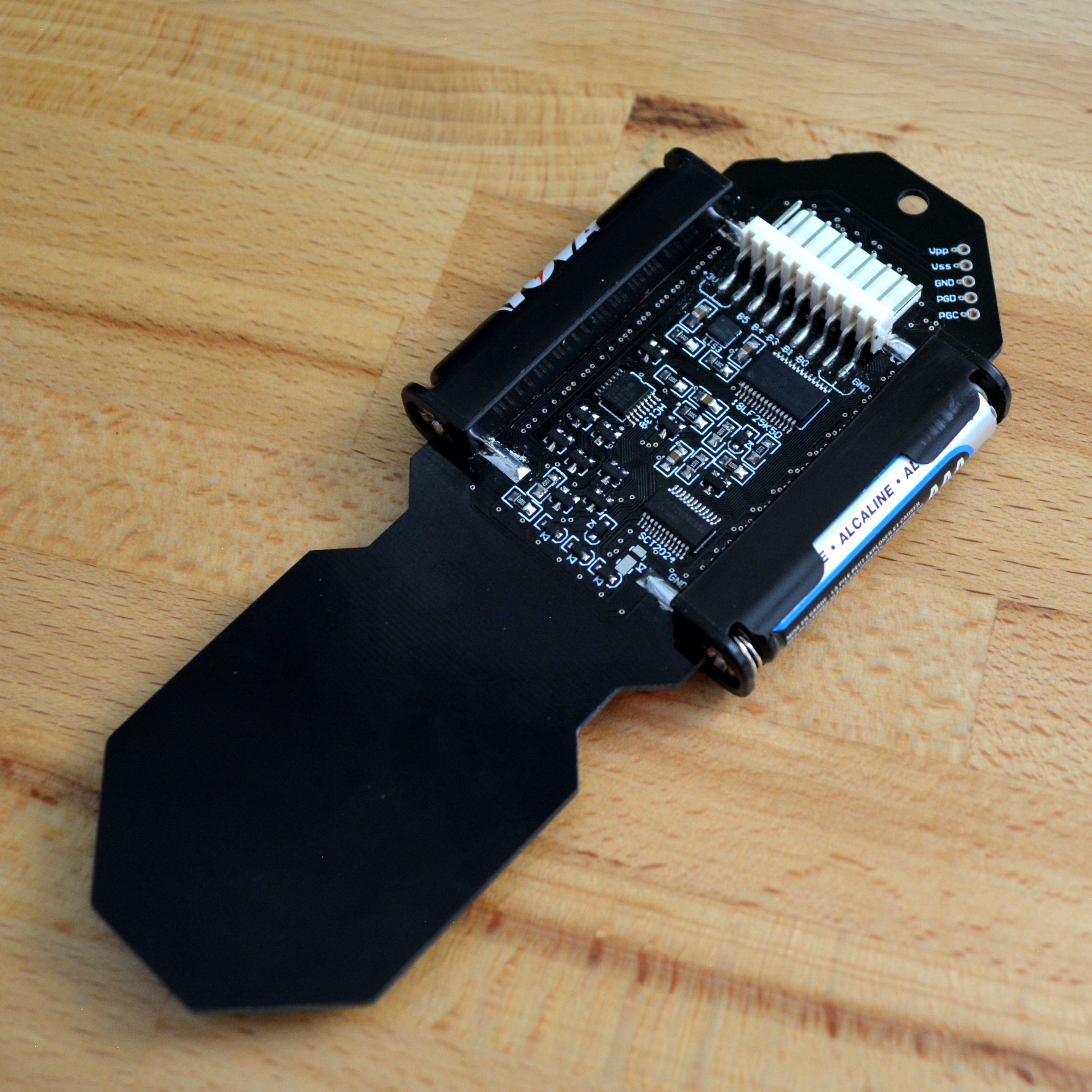

[Voja Antonic] based the design on the badge that he developed for the Hackaday Belgrade Conference in April (shown on the left). That was a stellar badge design, and [Voja] managed to improve on it for this one. I really like the edge-mounted single-AAA battery holders which, along with the replacement of the LED modules, cuts down on the thickness of the badge. They also reduce the weight, from 88 grams to 52 grams. Those with keen ears will note that I incorrectly quoted 62 grams in the video but the lower figure is correct.
There will be a few changes from what you see here. If you look closely you can see an acrylic bezel around the LEDs. On the final badge this will host an acrylic diffuser. This prototype, originally spun in June, has the incorrect location printed on it. The SuperCon will be in Pasadena, CA on November 5 & 6, 2016.

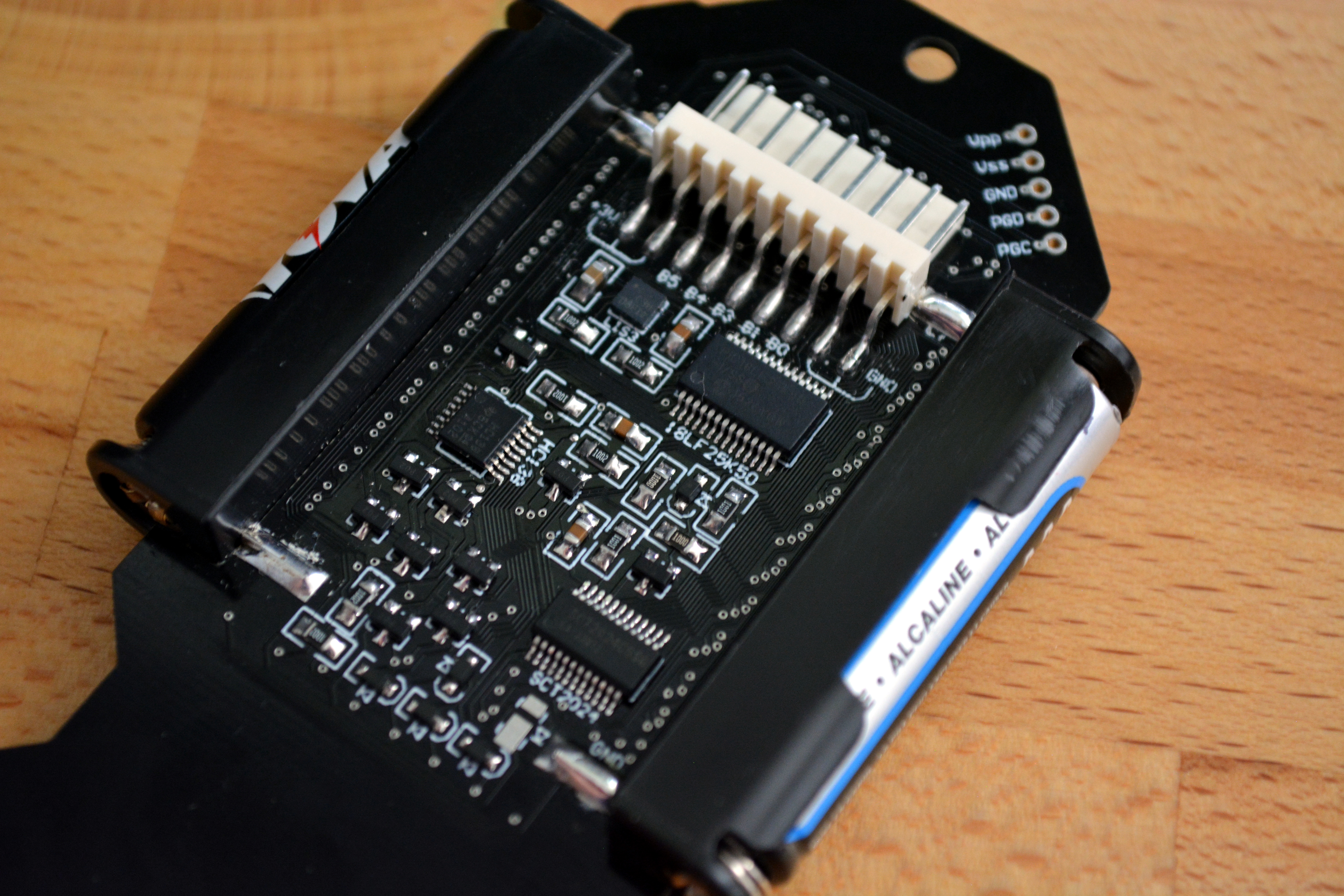

The nine-pin expansion header on the back is one more way that this badge is designed for hackability. We had such a great time last year with the bare-PCB hardware hacking it was important to provide direct access to the hardware on this badge. As with the amazing badge hacking of the Belgrade Conference, this badge is running a bootloader. It tends all of the hardware, providing memory-mapped access to the display, buttons, and peripherals. This means if you’ve never blinked an LED you will get up and running quickly. More seasoned programmers won’t have to get bogged down with low-level coding, and wizened experts can blow out the bootloader and go bare metal (don’t forget your PICkit).

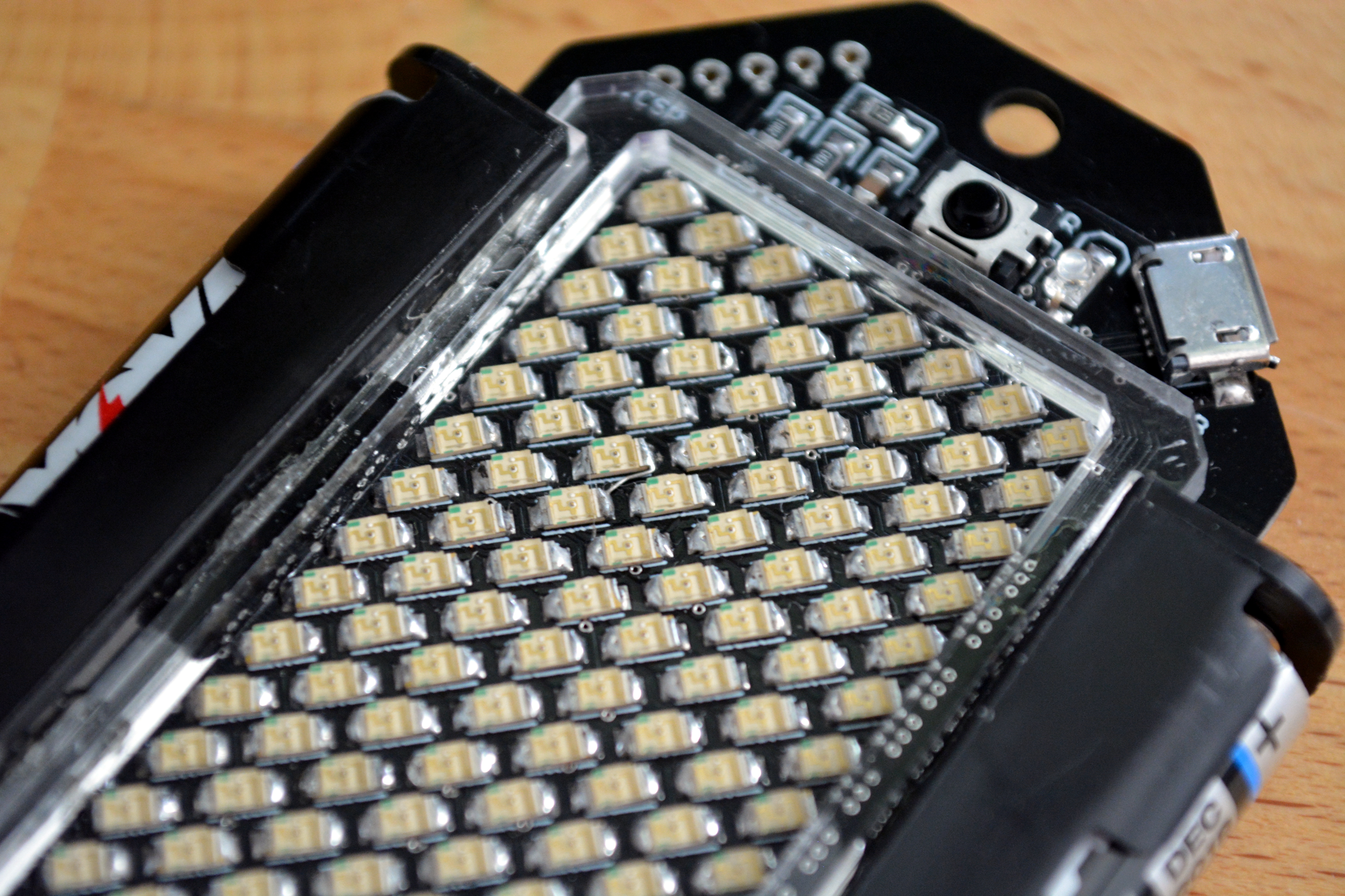

I want to take a moment to showcase the craftsmanship of this badge. Check out the layout, and the aesthetic — this is a thing of beauty. Now take a really close look at that LED matrix (click to embiggen). When [Voja] first sent me the prototype I thought there was some solder balls stuck to the flux. Wrong. What looks like a stray cat hair or solder splash is a tiny wire — ninja-level rework that [Voja] performed by hand before shipping this my way. Check out some of the other projects he’s posts.
