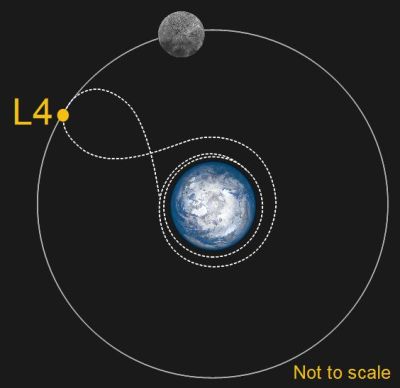

Route for the space bike race
The story is about an annual race called the Grand Tour du Système. The route starts out from low Earth orbit going to Lagrange point 4 (L4), a location along the Moon’s orbit where the Earth’s and Moon’s gravitational fields conspire to provide a stable position. From L4, the route continues halfway to the Moon and then returns to Earth orbit. Altogether it’s around 600,000 kilometers long.
The story doesn’t say how long the race takes but does give clues. The race is broken up into stages wherein the racers cycle non-stop, more-or-less, for around 36 hours. Each stage accelerates from 0 velocity relative to a docking station, then decelerates from a midway point so that the racer arrives at the next docking point also at, or close to, 0 relative velocity. It also says there are 30 variable length stages from Earth to L4, but we’re not told how many stages there are for the rest of the route. But guessing at 60 stages in total, that’s 2160 hours of stop-and-go pedalling (60 stages x 36 hours each).

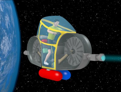

Decelerating using front thruster
The first interesting issue that gets pointed out in the story is the problem of how to turn the bike around at each stage’s halfway point in order to begin deceleration. After all, the Wimshurst machine disks are rotating at high speed and act like flywheels — they resist having their orientation changed and so it’s hard to turn the bike around to get the ion thruster pointed in the opposite direction. Instead they had to slow down the Wimshurst machines to the point where they could turn around and then take the time to spin them back up again. That slowing down and speeding up again is not something you want to do when racing.
To get around this, it’s mentioned that someone once won a few stages by secretly adding a second ion thruster to the bike on the front. Decelerating then became only a matter of switching the Wimshurst machine’s output from the back thruster to the front one. Of course, all racers soon added front thrusters too, negating the advantage.
During the current race in the story, one racer comes up with another innovation to win a stage. He redirects his thruster exhaust in a direction that is out of alignment with where he wants to go, but in the direction of the nearest racer. To quote the story:
“We were throwing a couple of tenths of a gram of ion propellant out the back of the bike at better than ten kilometers a second, but we were being hit by the same amount, traveling at the same speed. Net result: no forward acceleration for us.”

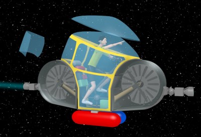

Jettisoning unneeded shielding
A big topic in space today, especially with all the talk of going to Mars, is radiation. Radiation shielding is heavy and plays a big part in the races. Interestingly, the racers talk about the “weather” as we would on Earth. Of course they’re talking about the solar wind, one of the sources of radiation. We can just imagine future space dwellers speaking in that way: “How’s the weather outside?”, “Windy”.
According to the rules, they can attach as much radiation shielding as they think they’ll need for the forecasted weather. No mention is made as to what the shielding is made of. Naturally the racers want to minimize the mass by minimizing the amount of shielding used. But they can be penalized if they exceed the maximum radiation dosage during a stage.
However, one racer comes up with a radiation related trick to win the final stage and the overall grand tour. The final stage is forecast to have stormy weather, which would peak during the stage. His trick is to modify his bike so that after the storm peaks and declines, he jettisons unneeded shielding. That gives him a lighter bike and so he’s able to go faster and have an easier time decelerating.

  10. Based on the calculations, isn’t the 36hr a little long? I mean you could accelerate for 3 hours, take more than a day nap/break, then decelerate for 3 hours, and still be beating the time.
    What would an actual reasonable amount of acceleration be from one of these?
    1. I think you have to deviate a little from the traditional way of doing bicycle tours. The main difference is, you don’t “stop for the night” in space; each leg takes you to a slightly higher orbit, and there would need to be “rest satellites” at each of these orbits, where waste is collected and the next day’s food is distributed. So the whole time you’re going from low Earth orbit to L4, you would always be accelerating. Conversely, to get back down to Earth, you have to decelerate the whole way, as each stage would take you to a lower orbit, requiring a lower velocity.
      That’s about the limit to my expertise in orbital dynamics; I don’t know how it works when you compare accelerating at different rates during each stage. I.e., if you accelerate too quickly, will you overtake the next rest satellite in its orbit, and then have to pedal back to get your food for the next day? Seems like that could be a problem.
      1. If you accelerate later in your orbit, you end up somewhere completely differently. Most likely having to use a lot more time/fuel to compensate later on.
        Also your fuel is more efficient the close you are to the planet see: https://en.wikipedia.org/wiki/Oberth_effect
        But my experience is limited here, only from KSP. Which doesn’t have the Lagrangian points, which could improve on the whole timing problem.

        That being said, I was surprised at the route proposed – until I saw the date of publication (1987). Why was I surprised? Because the obvious route choice isn’t L4 to a low Earth orbit and back. That route sucks – for one thing, you’d have to be concerned about satellites and the Van Allen belts, and especially near Earth, it’d be really difficult to actually have waypoints you can dock with. Plus, honestly, the route is boring: near Earth, gravity is simple. This is why the date made sense to me: back in 1987, the ludicrously complicated N-body math for farther out in the Earth-Moon system hadn’t been studied much.
        The obvious route choice is *between Lagrange points* – something like L1->L4->L2, or to get even more insane, the full loop through L1->L4->L2->L5->L1. Orbital mechanics for the Lagrange point orbits are *way* more complicated. From lunar L2 you could end up at the Earth-Sun L1 for extremely little energy. So there, you get a situation much more like real cycling, where it’s much more about route planning than anything else. The simplistic 3-body treatments here are from the late 70s (“Traveling Between the Lagrange Points and the Moon”, by Broucke) but the delta-V required between lunar Lagrange points and the Earth-Sun L1 point is extremely small (like well below 1 m/s), and the delta-V required between Earth-Sun Lagrange points and almost *any other* similar Lagrange point in the solar system is tiny. So orbits out there are super-complicated.

  12. If the discs are counter-rotating at the exact same speed (I assume they would be geared that way anyway), there would be no net angular momentum, and would turn as easily as if they were stopped. That’s a big “oops” in the original story, I presume.
    1. *This assumes that the structure is strong enough to handle the forces required when the wheels are at speed. Having not read the original story, perhaps that is the reason that the slowdown was needed. Martin’s idea would work, but it might be easier to have an independent wheel that you could spin up or down to apply the required torque to turn the bike.

  14. Xenon is about $1.20 a gram. So $60k to fill your bike.
    I dont think wimhursts will do it either, too high of voltage and too little current. You would be better off running a generator to power the drive electronics. If you really wanted to you could make the generators the wheels to keep it in your bike form factor.
    1. You are correct about Wimhursts. There’s a REASON we use electromagnetic generators and motors, and that reason is the energy density that can be stored in magnetic circuits compared to electrostatics. Sorry I don’t have the numbers at hand, but from what I recall from a university power electronics course, the difference was several orders of magnitude.
    2. And that $60k is for each leg of the tour, of which there are approximately 60, for $3.6 million. But hey, aluminum used to cost more than gold, so maybe in the future there’s cheap xenon, or a cheaper alternative.
      1. There are a lot of non-Xe ion thruster designs out there: the Xe thrusters are just the ones that have been actually used on spacecraft. But spacecraft ion thrusters are optimized for specific impulse, whereas here you’d actually want to optimize for thrust-to-power ratio, making non-Xe thrusters reasonable. Iodine, for instance, has been used in Hall effect thrusters with good thrust-to-power ratios, and iodine is an order of magnitude cheaper.
        1. There are also some designs using mercury. Of course that is not considered very “environmentally friendly”, but outside of the earth’s atmosphere that’s a non-issue. Hg would offer a very good density, a small tank.
      2. You could use krypton, it is cheaper but has a lower mass so less thrust. Xenon is just rare, I dont think there is anything you can do about it. After looking at xenon for a project I came up with a way to extract it from old xenon arc lamps. Most arc lamps are pressurized to about 10-15bar so if you are doing low pressure plasma stuff where you dont need much they can be a cheap supply of xenon.
