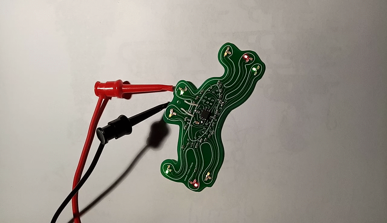

  22. In addition to the enduring fun of homebrewing and construction, what finally lured me into the hobby was the rise of software defined radio and digital modes, made possible by free and open source toolchains from the operating system right up to the pcb layout software, as well as open hardware designs made available by others for experimentation.
    I started in earnest by building a software defined radio, the SDR-CUBE, from a kit.
    I then taught myself PCB layout with the gEDA toolsuite on Linux with a morse keyer that displays the characters as you key, based on the PicAXE 28×2
    http://vk5hse.blogspot.com/2013/05/the-vk5hse-i-kaktusss-iambic-keyer.html
    Since then, I’ve played with gcc and AVRs, and written toolchains to enable more exotic PCB designs by leveraging other FOSS packages such as inkscape and fidocadj, allowing the creation of things like the following flying spaghetti monster
    https://1.bp.blogspot.com/-TdufSoR3PCE/WNKJ8D0VxBI/AAAAAAAAA0Q/xYhrqXjHVcE8XIb1puU0UI7KjsiAIlcawCLcB/s1600/FSM-flying-spaghetti-monster-hackvana-pcb-fidocadj-geda-pcb-rnd.gif
    And we can even put Klingon on a PCB now:
    http://hackaday.com/2017/04/01/new-fonts-for-geda-pcb-tool/
