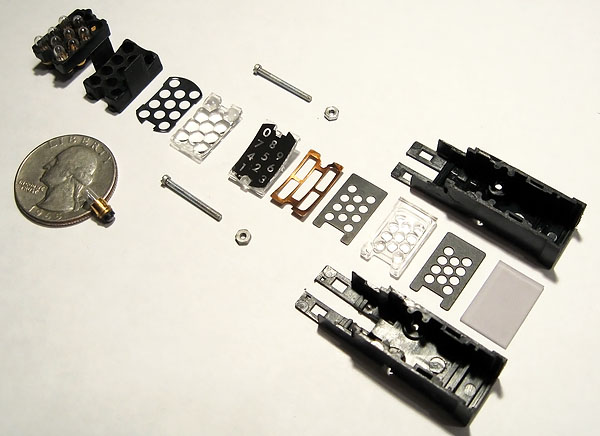

We recently featured an entertaining project here, a digital clock with a variety of different retro display technologies forming its numerals. Among those was an extremely unusual device, a rear-projection display with an array of bulbs each able to shine through a different letter or numeral slide. There was such interest in this device that its owner [Suedbunker] subjected one to a teardown for all to see.
The displays came from an organ which he suggests may have been manufactured around 1900. We suspect that may be a rather early estimate due to its use of a printed circuit board, but it is no less a fascinating device for it. A rectangular enclosure secured by twist-tabs opens to reveal a matrix of small filament bulbs on a PCB and supported by a stack of resin boards, in front of which was placed a slide with a letter or number for each one. Before that lies a sheet of glass, and then a molded plastic lens assembly which provides an individual lens for each of the 12 bulbs. When a bulb is illuminated with these in place, the letter or number is projected on the screen at the front of the unit.
It has the advantage of simplicity, no need for a high voltage, and high-quality characters and flexibility in displaying alternatives through different slides, though at the expense of quite a bulky package. The bulbs are quite energy-sapping, so for his clock he replaced them with LEDs. We like it as one of the more practical retro numeric displays, but its size means we probably won’t see a comeback.

Can’t quite see how the aiming is done. the lenses all seem to be the same and in a regular grid and the bulbs are “aimed” by the mask. so is it just that the letters mask has slight perturbation of the regular grid so the letters are centered on the display at that focal length ?
Also – if the lenses are all the same – can you get a closer look ? Are they half rounds. I like the ballbearing idea for making a mold.
My guess is that the spacing between the lamps, then the masks, then the lenses are progressively smaller, so that the optical line from each filament through the center of its mask and the center of its lens goes through the center of the screen. It’s also possible that the flat sides of the lenses are slightly angled, but I can’t confirm or refute either of these by looking at the pictures.
I did find an exploded picture of one of the similar IEE displays: http://www.industrialalchemy.org/media2/pict13/projection340exploded.jpg
In this unit, there is first a set of condenser lenses, then the masks, which are arranged on a spherical surface, then the imaging lenses.

These displays are *at least* about 50 years newer, they already use fiberglass PCB’s.
Nope. Only the front screen (diffuser) looks like a fibre-glass. The PCBs holding bulbs look more like phenolic resin based (FR-2?).
I had a couple of these in the 70s, which I purchased from the Honeywell Surplus Store on rt 9 in Framingham , MA. They were IEE brand, and came without any front covering (they were bolted to a translucent front panel?)
My guess is that the glass-fiber projection surface is a later addition. It’s a poor light transmitter, translucent plastic would have been a much better choice.
Yeah, the die casting and the lamps themselves put it in the 50’s at least. Plus the molded acrylic lens assy.
In fact looking at the teardown pics I would say probably 70s to 80s on construction. PCB backplane for the lamps and just general construction techniques.
