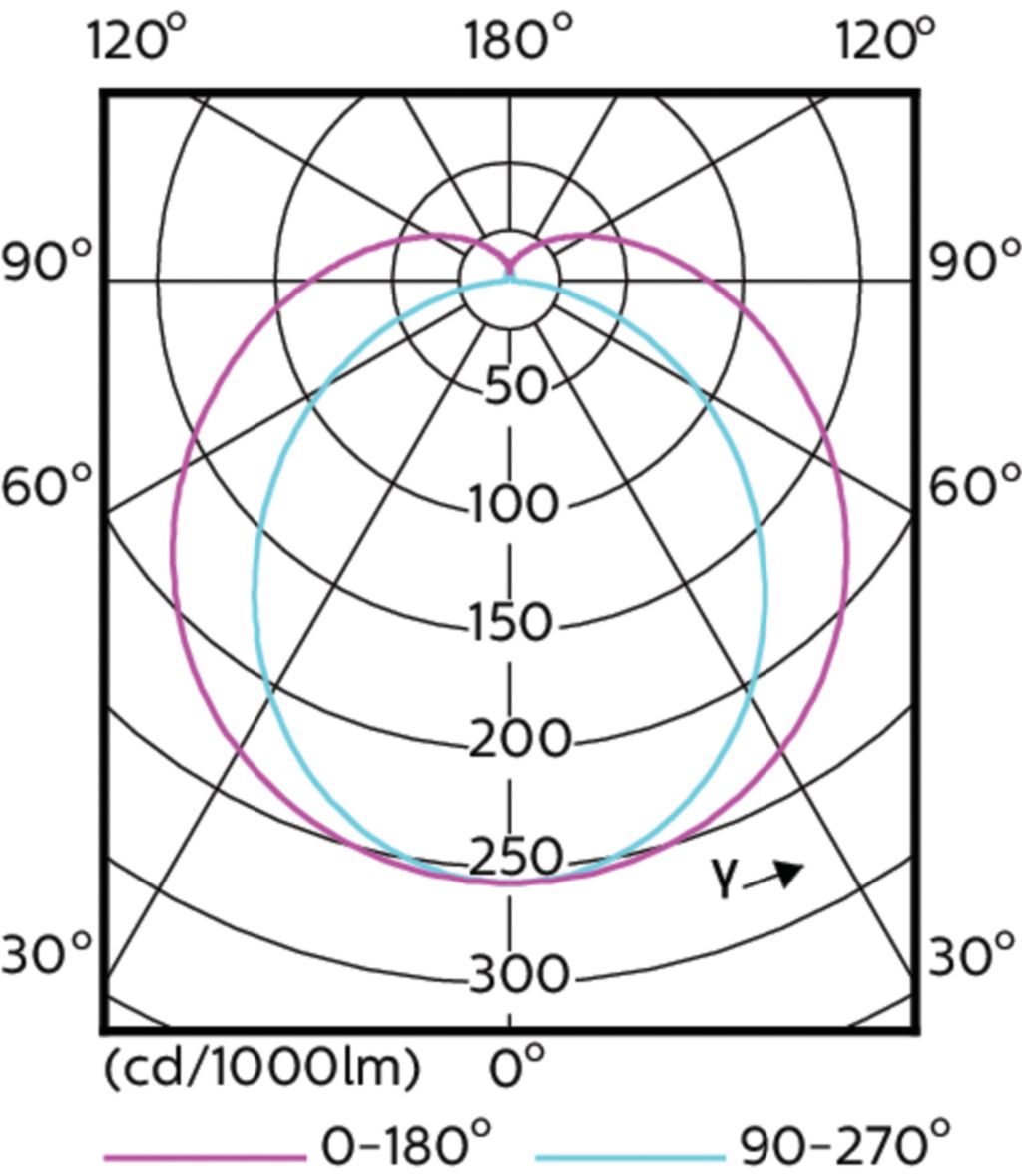

That’s rather difficult without a real integrating sphere, because the individual LEDs cast their light in a narrower angle, and their combined beam pattern isn’t uniform. In other words, if you put a lux meter underneath the light, you can find spots where it’s brighter or dimmer – and that’s still missing the point because the fluorescent tube lights up a lot more than just the floor directly underneath the fixture. Depending on the reflector, the light can be going more than 180 degrees around.
https://www.assets.lighting.philips.com/is/image/PhilipsLighting/b59a345e05cb487ca8a0a747006cabfb?wid=1024
Point being that in order to light up a _room_ you want the light onto the walls and ceiling as well to create diffuse light that doesn’t cast shadows. Ambient light makes the room bright. Pointing most of the light directly down to appease a luxmeter is cheating.
