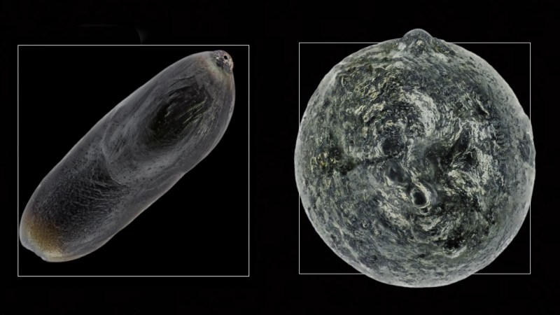

Micrometeorites photographed under the microscope. Credit: Jon Larsen
For a long time, micrometeorites were largely ignored by science due to the perceived difficulty in trying to find them. As Verge Science reports, Jon Larsen took this as a challenge. With an estimated 60-100 metric tons falling to Earth every day, Jon simply refused to believe that nothing could be done. Instead, he took a reverse approach at the problem, becoming an expert on all manner of tiny terrestrial particles. Beginning by collecting particles with a magnet, he would painstakingly sort and identify them. By first identifying all the particles of terrestrial origin, it then became easier to focus on whatever was left over to determine whether or not he had found a micrometeorite.

Images taken of micrometeorite finds with scanning electron equipment.
Papers have even been written on the collection of micrometeorites, long thought impractical due to the presence of heavy particulate pollution and human activity kicking up dirt and dust. For those interested in seeing micrometeorites explored with real hardware, the electron microscope images are a real treat. This kind of muscle is what’s needed to verify finds to a scientifically valid level.
