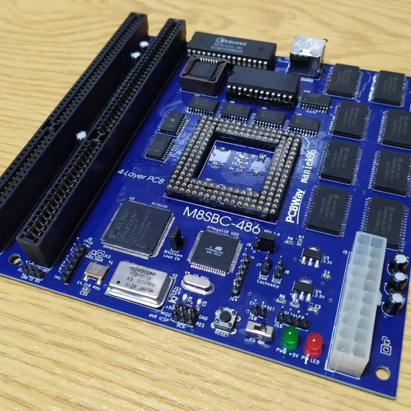

[Editor’s note: We got this one wrong! The computer uses an actual 486: the FPGA is running essentially as the chipset, interfacing the RAM and the ISA bus with the CPU. And since this went to press, [maniek-86] put out a nicer writeup of the project, which you should go check out, in addition to the GitHub link below.]
Given the technical specs of the FPGAs available to hobbyists these days, it really shouldn’t be a shock that you can implement a relatively-modern chipset on one, like one for a 486 system. In spite of knowing that in the technical sense, we were still caught off guard by [maniek-86]’s M8SBC project that does just that– the proas both CPU and BIOSducing a 486 FPGA chipset with a motherboard to boot.
Boot what? Linux 2.2.6, MS-DOS 6.22 or FreeDOS all work. It can run DOOM, of course, along with Wolfenstien 3D, Prince of Persia, and even the famous Second Reality demo– though that last without sound. [maniek-86]’s implementation is lacking direct memory access, so sound card support is right out. There are a few other bugs that are slowly being squished, too, according to the latest Reddit thread.
The heart of the system is a Xilinx Spartan II XC2S100 FPGA, which serves the motherboard chipset, codnamed “Hamster I”. The CPU is a vintage i486, running at a configurable 24MHz.  The BIOS code is based on an open-source project by [b-demitri1] that’s also on GitHub, if you happen to need a PC BIOS.  The FPGA isn’t doing everything: graphics is, as right and proper for a PC-compatible of this vintage, provided by an ISA card. [maniek] has tested several VGA cards and all apparently worked equally well, so that aspect of the system is apparently well in hand. The 4MB of system RAM seems pretty reasonable for a 486 build, as does restricting peripherals to PS/2 and the aforementioned ISA bus. We might have gone for a faster clock default than 24MHz, but that’s well within historical territory. Only a few bugs and the pesky lack of a DMA controller keep this from being a true PC-Compatible build, and that’s pretty amazing for one human’s hobby project.

  1. heart of the system is a Xilinx Spartan II XC2S100 FPGA, which serves as both CPU and BIOS
    No, the FPGA is not serving as CPU, there is real Intel 486DX2 on there, and does NOT serve as BIOS, there is real W29C020 serving rom contents.
    Despite using really fast SRAM instead of DRAM thus skipping designing own memory controller the speed is really really low at 17MB/s meaning cpu is running in 386 compatible mode (no burst).
    Using 5V toleant Spartan 2 was really smart!
    DMA and second PIC should easily fit inside FPGA.

    2. really lazy isn’t. I thought this looked exciting(and it still is) but theres a big glaringly obvious socket for a 486 in the very first picture. Hopefully the author will fix this “minor” issue!!!

    3. That’s very obvious from the architecture diagram embedded in the post. An author must have been very sleep-deprived to make such an unforced error. Hopefully it reads with better accuracy now.

    1. Yep. Had blog entry doesnt do justice to this AMAZING project. Author implemented:
      Intel 386/486 CPU bus handling
      ISA bus handling
      reused vintage 486 CPU
      reused vintage 8259 PIT (timer)
      reused vintage 8254 PIC (interrupts)
      maniek86 build a legit vintage PC motherboard the way companies did back in mid eighties designing own Chipsets, all on his own in a span of few months. The only missing component is old school DRAM memory controller, skipping it is no brainer as driving DRAMs is almost an art form (as much digital as analog) and learning how to create one could take another year with most time spend chasing quirks and compatibility woes.
      Want to hear something wild – this was maniek86s first 4 layer board ever :o Talk about jumping into deep water.
