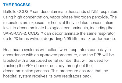

This is the promise of Battelle’s Critical Care Decontamination System, a shipping-container-sized unit which has received approval from the FDA at break-neck speed.
Hydrogen Peroxide: It’s Not Just For Rockets
Each container houses a main chamber into which the infected PPE is loaded protected by an airlock and a set of filters, and the decontamination magic happens courtesy of several hours’ exposure to hydrogen peroxide vapour. The mechanism of using hydrogen peroxide as a disinfectant is simple and well-understood, it’s a chemical that readily degrades into highly reactive hydroxyl radicals which in turn attack any organic material they encounter. This effectively neutralises any viruses or bacteria that may be present on the PPE, leaving it clean and disinfected for its next user, and with the whole cycle from start to finish including loading and unloading taking twelve hours. The particularly flexible aspect of the system comes in its shipping container home, making it very straightforward to move from place to place where it is needed using standard trucks and loading equipment.
All this is most impressive and has the potential to be a game-changer for hard-pressed hospitals in the thick of the epidemic, but it is dangerous to latch onto any one solution and long-term the best solution will still be to build up a sustained manufacturing effort all PPE that is in short supply.

VHP (vaporized hydrogen peroxide) is not that destructive to plastics and fibers, since it just reacts with the surface layer of the fibers. It can however oxidize metals fairly quickly. Usually we use steels 316L and better to prevent/minimize corrosion.
UV on the other hand can break chemical bonds of the plastic fibers. (that’s why initial experiments showed that the rubber bands of the masks deteriorated) Since UV cannot pentrate effectively after the first layer of fibers you will have to use a higher dose causing even more issues.
Overall if you compare the two solutions you will see more reliability issues with UV (due to shading) than you will see with VHP. Since this is a safety issue regarding high volumes of material reliability is key.
Note: Biopharma uses both technologies but prefers VHP for this exact reason

Sterilization of something that’s intended as single-use is *not* trivial. What the article doesn’t mention is that the sterilization can only be done 20 times before the mask starts to physically degrade. If the process could be done like, 1000 times or something, then it’d be trivial: you just date the masks, sterilize them each day, and toss them after a year or so. Wouldn’t matter that you don’t have a perfect count of the number of times.
But when the limit is 20 times, the logistics become a *ton* more complicated. Now you really, really need to take care to make sure you’re tracking everything, and you need to inspect each of them to make sure that they aren’t damaged by use (outside of your sterilization) as well.
Now do all of this 80,000 times a day. I don’t even know if I could mark 80,000 masks with a sharpie in a day without going mad.

When something is intended for single use, and 20 counts degrades it, that means you’ll need to inspect each of them to make sure they’re still usable, *in addition* to tracking them. These things weren’t meant to be reused. That’s not exactly something you can automate, which means humans. Which means now you also need to make sure your humans inspecting them stay sterile too. Which means the simple procedure gets a ton more complicated.
This isn’t me making things up, either, details on this are all in the original Battelle report from the FDA study several years ago.
