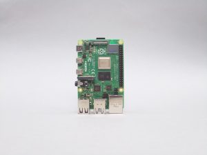

Here is the Pi camera v2 https://www.raspberrypi.org/app/uploads/2020/04/Camera-Module-V2-3280x2464px-300×225.jpg

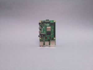

And here is the new one https://www.raspberrypi.org/app/uploads/2020/04/HQ_CAM_W_6mm-4056x3040px-300×225.jpg
Those two shots are next to worthless. 300×225? You could easily convince me that’s the same camera with a slightly different lighting and camera placement. Can we get some full res shots?
You get the original if you remove the 300×225 part of the URL. The new one looks much better, but it looks like it’s more about the quality of the lens, rather than the sensor.
Thanks for linking to a sample image. This is quite impressive if I do say so myself.
