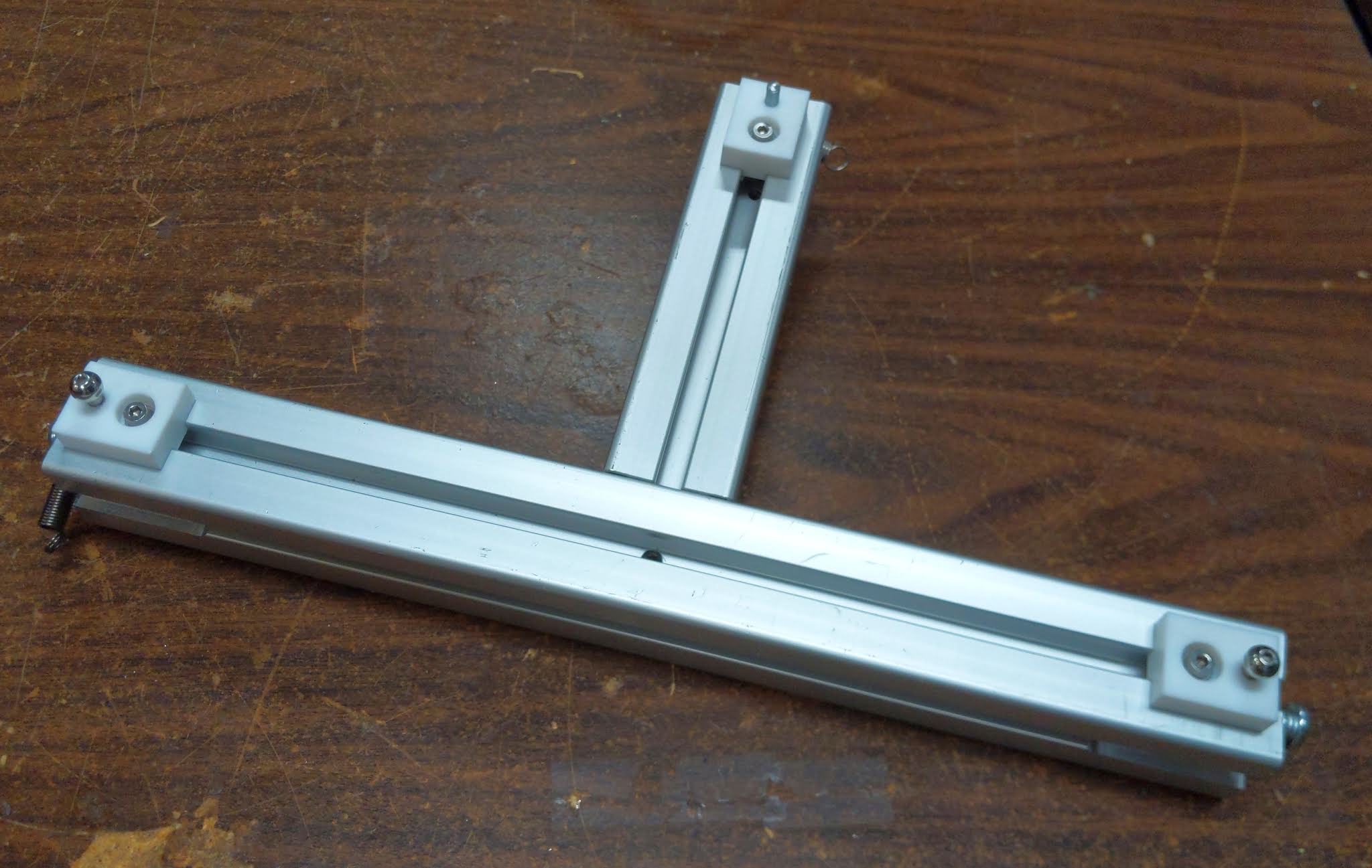

        My 300x300x680 mm print capacity corexy machine has all the mentioned features. I put it together for about $800, but I’m pretty resourceful when it comes to sourcing parts and materials. You don’t have to build the whole machine- you can easily replace a crappy bed support and floppy bed plate for relatively low cost. It costs even less to belt the Z axis screws to a single motor- all you need are a couple pulleys and a loop belt.
        My printer’s bed uses a piece of cast aluminum tooling plate that you can buy via ebay for $20-30. You can cut it to size using a hacksaw (it’s aluminum!). You can drill it with any drill (it’s aluminum!). If you don’t have a hacksaw or drill or access to them, maybe it’s time to invest in some tools – your life will be much better.
        The plate is supported on a kinematic mount by three screws because 3 points define a plane in the universe we inhabit. Springs are used to hold the plate down on the screws, not up. The mount allows the plate to expand when heated without pushing laterally on anything or causing anything to bend. The plate is the same size as the heater so it heats uniformly and exhibits minimal warping when heated. Unlike nonsensical 4 screw mounts, it takes literally seconds to level the plate when you install it on the machine, and you won’t have to touch it again. You can use a kinematic mount on any printer, whether the bed moves in X, Y, or Z.
        Once you have a stable mount and a flat, level bed, you’ll set Z=0 once and won’t have to touch it again.

        The bed is 300×300 cast aluminum tooling plate, which comes milled flat (that’s why it’s called tooling plate), covered with PEI. It is trammed and zeroed at 100C, and is flat enough to print edge to edge in 0.2 mm layers, any material I use, including TPU, ABS, PETG and very rarely PLA. All those materials stick to PEI without any extra goo smeared on the bed.
        The bed is on a kinematic mount that lets it expand without pushing anything laterally. It sits on 3 screws arranged so one controls pitch and another controls roll. The roll adjustment doesn’t affect pitch, so you set pitch first, then roll, and the tramming is done. The leveling screws are held in PTFE blocks that hold the screws securely and allow them to be turned easily for tramming. The PTFE blocks are mounted on a 4040 t-slot support “tee”. See: https://1.bp.blogspot.com/-hBQHaLXxLHc/XMkKqdyk1NI/AAAAAAAAZgM/TG5-gE6UepYyg2v7If3qYDH7DjdXleIagCPcBGAYYCw/s2048/bed%2Bsupport.jpg The support rides on linear guides and is lifted by belts in the Z axis.
        It has been operating with perfect reliability requiring retramming only after I make mods to the machine’s Z axis which is pretty rare, last time about 8 months ago, IRIC. The printer is large and heavy and I transport it laying on its back in my car. When I take it out, I stand it back up and start printing without and adjustments.
        I have changed extruders, nozzles, heater blocks, etc., and then have to rezero, about a 10 second operation. I think the last time I did that was 6 months ago. I don’t have problems with clogged extruders as I almost never print PLA, which seems to be a real nozzle clogger. I have never had much use for PLA.
