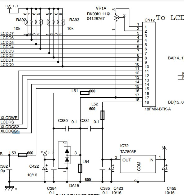

Repairing electronic devices isn’t as hard as it used to be. Thanks to the internet, it’s easy to find datasheets and application notes for any standard component inside your gadget, and once you’ve found the faulty one, you simply buy a replacement from one of a million web shops — assuming you don’t end up with a fake, of course. When it comes to non-standard components, however, things get more difficult, as [dpeddi] found out when a friend asked him for help in repairing a Roland Juno-G synthesizer with a broken display.
The main issue here was the fact that the display in question was a custom design, with no replacement or documentation available. The only thing [dpeddi] could figure out from the service manual was the basic pinout, which showed a parallel interface with two lines labelled “chip select” — an indication that the display contained two separate controllers. But the exact protocol and data format was not documented, so [dpeddi] brought out his logic analyzer to try and decode the signals generated by the synthesizer.
After a bit of trial and error, he was able to figure out the protocol: it looked like the display contained two KS0713-type LCD controllers, each controlling one half of the screen. Finding a compatible replacement was still proving difficult, so [dpeddi] decided instead to decode the original signals using a microcontroller and show the picture on a modern LCD driven by SPI. After some intial experiments with an ESP32, it turned out that the task of reading two reasonably fast parallel buses and driving an even faster serial one was a bit too much for the ESP, so [dpeddi] upgraded to a Raspberry Pi Pico. This worked a treat, and thanks to a 3D-printed mounting bracket, the new display also fit snugly inside the Roland’s case.

    However the original (?) schematic look a lot like the “standard” 128×64 3D-printer display (SS-something driver). I don’t know if I got it right but maybe there is easier way to replace rather than using totally different standard display + raspberry pico ?
      1. The original display was a 240×96 pixel with 2 chip select. Roland itself released new display revision for warranty that required a new firmware, but the price was expansive and now out of production. The original display was quite big about 150x60mm.. nowadays you can find 240×128 LCD and the price is higher than a TFT. And usually smaller then required.

    1. The keyboard CPU is a HD6417706F133 that is clocked at 133 MHz. Faster then the default clock of the ESP32. Originally I hope to use just a loop, then I thought to use irq to poll for display data, but the microcontroller interrupt speed was around 100/200khz, while the data frequency was around 7mhz. With the ESP32 using DMA I was able to get the half display working by using the one chip select line to clock the i2s circuit. So the answer is ESP32 could have worked using DMA but not in this situation because of the two CS lines.
      The ESP32 have two I2S peripheral but the data sheet says that just one could be used in parallel mode at the same time…

      However the information about which data pin on keyboard lcd bus and the rpi pico can be retrieved by:
      https://github.com/dpeddi/LCDJunoG/blob/main/platformio.ini
      so, look at following image…
      https://www.depieri.net/wp-content/uploads/2022/10/image.png
      with a tester locate the lcd pin 18 (5v) and 17 (gnd), then locate 15(3,3v)
      – connect 18 to rpi-pico vsys
      – connect 17 to rpi-pico gnd
      then look all other pin on the image to the pio port referenced on platformio.ini
      eg:
      JUNO_D0=2 (2 is the rpi pio pin 2)
