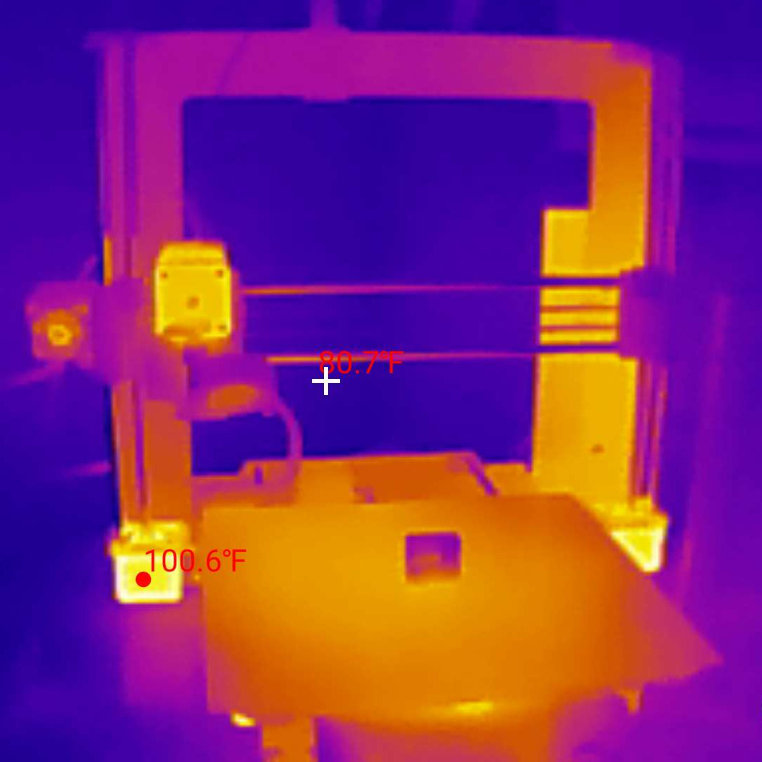

Thermal Gallery
Because it seems like the kind of thing you’d like to see in a review of a thermal camera, here are a random selection of images I’ve taken with the device over the last week or so.

In the end, I have to admit that the P2 Pro really impressed me. Not only does the resolution, frame rate, and macro lens make it an excellent tool for diagnosing hardware of all shapes and sizes– it’s just a whole lot of fun to look at the world through this device. I’d like to see the Android software get tightened up here and there, but I never ran into any issues that were big enough to prevent me from recommending the product to others.
At $299 USD the InfiRay P2 Pro is priced to compete with similar devices from FLIR, while at the same time offering higher specs in key areas. Consider the FLIR ONE Pro, which would set you back $420, yet only offers 160×120 resolution and is considerably larger and heavier. There are of course cheaper thermal camera options out there, but from what we’ve seen, they’re often more of a novelty than a useful tool. If you’ve been considering adding a thermal camera to your toolbox but were put off by the price-performance ratio of what was on the market previously, the P2 Pro might just be what you’ve been waiting for.
