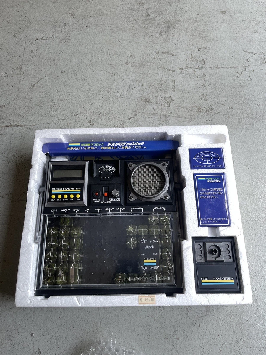

  6. Bit of a blind shot in the dark here but has anyone got much detail beyond the Wikipedia entry on the Gakken FX series? Specifically looking for:
    – the English language manual for the Micro-Computer FX-System FX-Computer
    – the range of models
    – any English language write ups on them, ideally with knowledge of the FX series to compare to
    – the modules unique to each module
    – how much cross compatibility there are between kits (e.g. while basic denshi blocks would post no issue could the EX-System Synth module be used in the FX board or are there critical differences)
    Regarding the last point I see the following modules (including full text to improve googleability):
    – Computer FX-System (4 bit computer)
    – CDS FX-System (not sure what this is yet)
    – Clock FX-System (just a digital clock ?)
    – Sound Block 1 FX-System ( seen here https://i.ebayimg.com/images/g/ChoAAOSwfNpjnAFx/s-l1200.webp )
    It also looks like the top center section of the body may be able to accomodate an analogue meter in the same manner as the EX-150
    1. I have the FX-Computer (aka FX R-165). There were a number of write ups on the FX Computer in contemporary British hobby electronics and computer magazines.
      – Everyday Electronics UK, April 1983 (pg. 217) and May 1983 (pp. 276-277)
      – Hobby Electronics UK, August 1983 (pp. 8-9) and October 1983 (pp. 16-17)
      – Personal Computer World (PCW) UK, November 1983 (pp. 176-177 & 243)
      These are all available from World Radio History: https://www.worldradiohistory.com/
      I think your definition of range is a bit expansive. There was a more recent write up on the history of the EX System (and FX System) series in the Japanese language Gakken Adult Science Magazine, Vol. 32. In it they only list two kits: The “FX Computer” and the “FX Melody and Watch”.
      https://otonanokagaku.net/magazine/vol32/
      The CDS module is simply a CdS light dependant resistor (LDR) and was included with the FX-Computer. Likewise, the Sound Block was included with the “FX Melody and Watch”. The “Watch” does appear to be a basic LCD clock, but it does appear to have an alarm function of some sort.
      Many of the blocks would be interchangeable between the two systems. However, the EX System kits run at 6V (4x AA) while the FX System kits run at 9V (6x AA). As such some of the EX System blocks could be damaged if they were used in the FX System kits. In particular the FX System kits come with lamps (bulbs) specifically marked 9V. Using a 6V bulb from the EX System could result in it burning out. Likewise you might have issues with other sensitive vintage blocks from the EX System kits, such as transistors.
      Interestingly, there was one 9V part for the EX System kits: the synthesizer block. The synthesizer block required a dedicated PP3 9V battery, installed within the front of the block itself. It was include with the top specification kit, the EX-181.
      The FX System kits do indeed have a window for the meter, and the unit has terminal spaces marked for such. You could certainly get the meter separately for the EX System. The idea of the series was that you could buy-in at any level and slowly upgrade to the top of the line EX-181 kit by buying intermediate upgrade parts. If I recall from my FX- Computer, in the FX System units the cover is held in place with an (internal) screw facilitating an upgrade; however, I don’t think the meter was ever offered specifically for the FX System kits.
      In fact, the write up in the Gakken magazine indicates that the two FX System units were the last of the Denshi electronic blocks offered by Gakken until the EX-150 reproduction in 2001 and the mini kit that came with the magazine itself in 2011. The article blames the demise of the FX System (and electronic blocks more broadly) on the emergence of other electronic toys and, in particular, a new computer in town: the Famicom, or the Nintendo Entertainment System as we would come to know it in the West. The rest, of course, is history.
