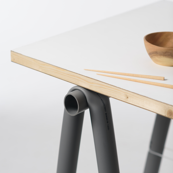

[Baptiste Marx] shares his take on designing emergency structures using PVC pipe in a way that requires an absolute minimum of added parts. CINTRE (French, English coverage article here) is his collection of joint designs, with examples of how they can be worked into a variety of structures.
Basic joints have many different applications.
PVC pipe is inexpensive, widely available, and can often be salvaged in useful quantities even in disaster areas because of its wide use in plumbing and as conduits in construction. It can be cut with simple tools, and once softened with heat, it can be re-formed easily.
What is really clever about [Baptiste]’s designs is that there is little need for external fasteners or hardware. Cable ties are all that’s required to provide the structural element of many things. Two sawhorse-like assemblies, combined with a flat surface, make up a table, for example.
Soda bottles made from polyethylene terephthalate (PET) are also common salvage and can be used as surprisingly sturdy heat-shrink and even turned into twine or rope; perhaps that could be an option if one doesn’t even have access to cable ties.

  3. Shelter? Cute. I don’t see any reference to wind loading capacity/snow roof load etc. What I do see is the rediscovery that PVC pipe can be bent with a bit of heat, layered in with artist’s statements and a student project.
    “I base my practice on contextualized object design,” he writes. “Sensitive to an aesthetic resulting from materials and manufacturing processes, I favor an experimental and reflective approach, where research occupies a central place. Between sensitive and technical creations, I seek to develop a multidisciplinary and conscious design.”*
    ” CINTRE responds to this emergency by offering a system that allows shelters to be built quickly while guaranteeing long-term safety and dignity.”
    PVC tubing/tarp portable garages (which this is copied from) can be gotten through the usual sources and will likely be more sturdy. Long-term safety is absolutely not going to happen with this. Likely dignity will go out in the wind and rain as well.

  5. It’s easy to talk smack about this as if it’s intended to be permanent and sensible (it’s not, it’s more akin to an art project) but experimenting like this is actually a very good design exercise.
    1. Yep. Some of the joints make sense, like flattening the tube and wrapping it around into a T-joint. That’s harder to do neatly by other means.
      Noodling around with PVC pipes doesn’t need to be about excuses like disaster relief though. For the engineering minded, just coming up with novel ways to join pieces together is enough. That is the value of the exercise.

      2. It’s all about the annealing.
        Melted and folded like this, then strained, the PVC will crack in days, maximum.
        Emergency facilities sometimes have to stand more then days.
        Besides this is a GD artist attempting engineering…or gaming grant system like Conor says.

  7. Since scientists are working on this, they could calculate the strength of the structure. I would like to know how much weight such a table or chair can hold. Or whether a tent covered with plastic sheeting rather than fabric can withstand winds of, say, x km/h.
    1. Why would you want a scientist to do engineer work?
      Wouldn’t you prefer an answer?
      Strength will depend non-linearly on the exact temperature the pipe was melted to and how much internal strain is frozen into each joint as it cooled.
      I’d expect the distribution to be bad enough that the life of a heat bent PVC structure would largely be determined by the single worst bend in it (insert B. Clinton Joke here).
      Failure rate a function of # of parts.
    2. First you have to ask, what kind of PVC pipe do you have? Water pipe, electrical conduit? Other? What impact resistance, what plasticizers? What temperature rating?
      PVC goes brittle in the cold, unless specifically formulated to remain soft, so the tent may fall to pieces when the weather goes below +10 degrees C. But if it doesn’t, the material might be too soft to handle +30 degrees C weather and it could bend out of shape under load. It also doesn’t do very well against UV light, so exposure to the sun would quickly degrade it.
      In other words, PVC is a rather poor material for structural purposes when exposed to the elements.
