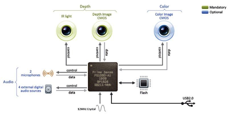

Hardware-wise, the Kinect features a color camera, an infrared laser projector and a monochrome camera capable of capturing the scene including the projected IR pattern. The simple process of adding a known visual element to a scene allows a subsequent algorithm to derive fairly precise shape information based on where the pattern can be seen and how it was distorted. As this can all be derived from a single image frame, with the color camera providing any color information, the limiting factor then becomes the processing speed of this visual data.
Prime Sense diagram of their reference depth sensor platform. (Source: iFixit)
PrimeSense diagram of their reference depth sensor platform. (Source: iFixit)

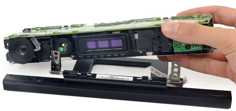

After the relatively successful original Kinect for the XBox 360, the XBox One saw the introduction of a refreshed Kinect, which kept the same rough layout and functioning, but used much upgraded hardware, including triple NIR laser projectors, as can be seen in the iFixit teardown of one of these units.
The naked front of the XBox One Kinect, featuring the same RGB and IR camera setup alongside an IR projector. (Credit: iFixit)
The naked front of the XBox One Kinect, featuring the same RGB and NIR camera setup alongside an NIR projector. (Credit: iFixit)
In both cases much of the processing is performed in the control IC inside the Kinect, which in the case of the original Kinect was made by PrimeSense and for the XBox One version a Microsoft-branded chip presumably manufactured by ST Microelectronics.
The NIR pattern projected by the PrimeSense system consists of a static, pseudorandom dot pattern that is projected onto the scene and captured as part of the scene by the NIR-sensitive monochrome camera. Since the system knows the pattern that it projects and its divergence in space, it can use this as part of a stereo triangulation algorithm applied to both. The calculated changes to the expected pattern thus create a depth map which can subsequently be used for limb and finger tracking for use with video games.

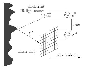

The ToF phase-measurement principle. (Credit: Sarbolandi et al., 2015)
Here it’s interesting to note that for the second generation of the Kinect, Microsoft switched from SL to ToF, with both approaches compared in this 2015 paper by Hamed Sarbolandi et al. as published in Computer Vision and Image Understanding.
Perhaps the biggest difference between the SL and ToF versions of the Kinect is that the former can suffer quite significantly from occlusion, with up to 20% of the projected pattern obscured versus up to 5% occlusion for ToF. The ToF version of the Kinect has much better low-light performance as well. Thus, as long as you can scan a scene quickly enough with the ToF sensor configuration, it should theoretically perform better.
Instead of the singular scanning beam as you might expect with the ToF approach, The 2013 Kinect for XBox One and subsequent Kinect hardware use Continuous Wave (CW) Intensity Modulation, which effectively blasts the scene with NIR light that’s both periodic and intensity modulated, thus illuminating the NIR CMOS sensor with the resulting effect from the scene pretty much continuously.
Both the SL and ToF approach used here suffer negatively when there’s significant ambient background light, which requires the use of bandpass filters. Similarly, semi-transparent and scattering media also pose a significant challenge for both approaches. Finally, there is motion blur, with the Kinect SL approach having the benefit of only requiring a single image, whereas the ToF version requires multiple captures and is thus more likely to suffer from motion blur if capturing at the same rate.
What the comparison by Sarbolandi et al. makes clear is that at least in the comparison between 2010-era consumer-level SL hardware and 2013-era ToF hardware there are wins and losses on both sides, making it hard to pick a favorite. Of note is that the monochrome NIR cameras in both Kinects are roughly the same resolution, with the ToF depth sensor even slightly lower at 512 x 424 versus the 640 x 480 of the original SL Kinect.

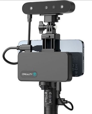

The Creality CR-Scan Ferret Pro 3D scanner, with iPhone in place. (Credit: Creality)
It should probably not come as a massive surprise that the 3D scanners that you can can purchase for average consumer-levels of money are highly reminiscent of the Kinect. If we ogle the approximately $350 Creality CR-Scan Ferret Pro, for example, we’d be excused for thinking at first glance that someone stuck a tiny Kinect on top of a stick.
When we look at the user manual for this particular 3D scanner, however, we can see that it’s got one more lens than a Kinect. This is because it uses two NIR cameras for stereoscopic imaging, while keeping the same NIR projector and single RGB camera that we are used seeing on the Kinect. A similar 30 FPS capture rate is claimed as for the Kinect, with a 1080p resolution for the RGB camera and ‘up to 0.1 mm’ resolution within its working distance of 150 – 700 mm.
The fundamental technology has of course not changed from the Kinect days, so we’re likely looking at ToF-based depth sensors for these commercial offerings. Improvements will be found in the number of NIR cameras used to get more depth information, higher-resolution NIR and RGB sensors, along with improvements to the algorithms that derive the depth map. Exact details here are of course scarce barring someone tearing one of these units down for a detailed analysis. Unlike the Kinect, modern-day 3D scanners are much more niche and less generalized. This makes them far less attractive to hack than cheap-ish devices which flooded the market alongside ubiquitous XBox consoles with all of Microsoft’s mass-production muscle behind it.
