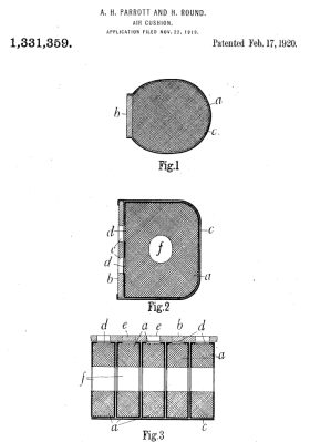

The first patent for an airbag safety device was filed over 100 years ago, intended for use in aircraft. Credit: US Patent Office
Once an obscure feature only found in luxury vehicles, airbags became common safety equipment in many cars and trucks by the mid-1990s. Indeed, a particular turning point was when they became mandatory in vehicles sold in the US market from late 1998 onwards, which made them near-universal equipment in many other markets worldwide. Despite their relatively recent mainstream acceptance, the concept of the airbag actually dates back a lot farther.
The basic invention of the airbag is typically credited to two English dentists—Harold Round and Arthur Parrott—who submitted a patent for the concept all the way back in 1919. The patent regarded the concept of creating an air cushion to protect occupants in aircraft during serious impacts. Specific attention was given to the fact that the air cushion should “yield readily without developing the power to rebound,” which could cause further injury. This was achieved by giving the device air outlet passages that would vent as a person impacted the device, which would allow the cushion to absorb the hit gently while reducing the chance of injury.

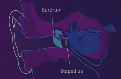

In humans, the stapedius muscle can be triggered reflexively to protect the ear from excess sound levels, though the mechanism is slow enough that it can’t respond well to sudden loud impulses. However, pre-emptively triggering it before a loud event can be very useful. Credit: Mercedes Benz
The stapedius reflex (also known as the acoustic reflex) is one of the body’s involuntary, instantaneous movements in response to an external stimulus—in this case, certain sound levels. When a given sound stimulus occurs to either ear, muscles inside both ears contract, most specifically the stapedius muscle in humans. When the muscle contracts, it has a stiffening effect on the ossicular chain—the three tiny bones that connect the ear drum to the cochlea in the inner ear. Under this condition, less vibrational energy is transferred, reducing damage to the cochlea from excessive sound levels.
The threshold at which the reflex is triggered is usually 10 to 20 dB lower than the point at which the individual feels discomfort; typical levels are from around 70 to 100 dB. When triggered by particularly loud sounds of 20 dB above the trigger threshold, the muscle contraction is enough to reduce the sound level at the cochlea by a full 15 dB. Notably, the reflex is also triggered by vocalization—reducing transmission through to the inner ear when one begins to speak.
