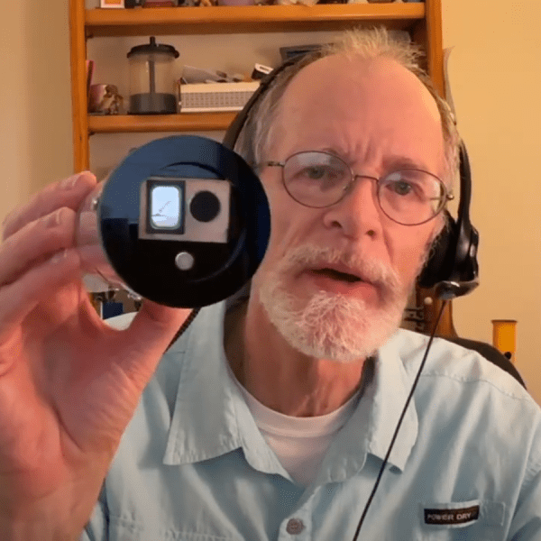

An intriguing mouth-played instrument emerged—and won—at the 2023 Guthman Musical Instrument Contest hosted by Georgia Tech. [Keith Baxter] took notice and reproduced the idea for others to explore. The result is the Zen Flute Mouth Theremin, a hybrid of acoustics, electronics, and expressive performance.
At its core lies a forced Helmholtz resonator, a feedback system built with a simple microphone and speaker setup. The resonator itself? The user’s mouth. The resulting pitch, shaped by subtle jaw and tongue movements, is detected and used to drive a MIDI controller feeding an external synthesizer.
Like a trombone or classic electromagnetic theremin, the Zen Flute doesn’t rely on discrete notes. Instead, the pitch is bent manually to the desired frequency. That’s great for expression, but traditional MIDI quantisation can map those “in-between” notes to unexpected semitones. The solution? MIDI Polyphonic Expression (MPE). This newer MIDI extension allows smooth pitch transitions and nuanced control, giving the Zen Flute its expressive character without the hiccups.
Physically, it’s an elegant build. A flat speaker and microphone sit side-by-side at the mouth end, acoustically isolated with a custom silicone insert. This assembly connects to a length of clear PVC pipe, flared slightly to resemble a wind instrument. Inside, a custom PCB (schematic here) hosts a mic preamp, an audio power amp, and a Teensy 4.1. The Teensy handles everything: sampling the mic input, generating a 90-degree phase shift, and feeding it back to the speaker to maintain resonance. It also detects the resonant frequency and translates it to MPE over USB. A push-button triggers note onset, while a joystick adjusts timbre and selects modes. Different instrument profiles can be pre-programmed and toggled with a joystick click, each mapped to separate MIDI channels.

Is the driver speaker loud enough to feel in your mouth? Seems like that would allow for a natural feedback in the musician, as opposed to them closing the loop on the sound that comes out of the device some many ms later and processed. This would give real physical feedback to the user on actual native pitch of the signal regardless of further processing and intrinsic delays.
I don’t feel vibrations in my mouth when I whistle; feedback is via the ears there too. Just because a computer is involved doesn’t mean there’s any appreciable human-scale latency; MIDI instruments would have all been dead in the water otherwise.
You do feel feedback if you use a reed instrument though.
As for whistling. you feel your mouth’s movement and muscle modulation, and even if you aren’t directly consciously aware.
It’s quite amazing how many kinds of proprioceptors we have and how much we rely on them without even realizing.
i think you just don’t know you can feel a whistle from the inside of your mouth
