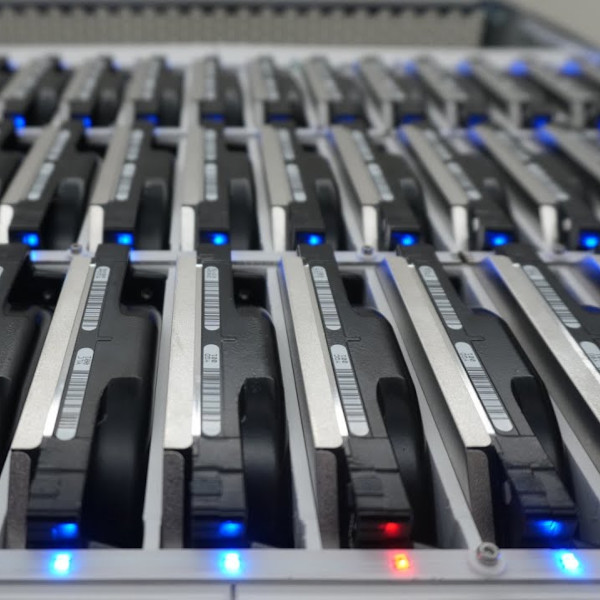

Self-hosting a few services on one’s own hardware is a great way to wrest some control over your online presence while learning a lot about computers, software, and networking. A common entry point is using an old computer or Raspberry Pi to get something like a small NAS, DNS-level adblocker, or home automation service online, but the hobby can quickly snowball to server-grade hardware in huge racks. [Dennis] is well beyond this point, with a rack-mounted NAS already up and running. This build expands his existing NAS to one which can host a petabyte of storage out of consumer-grade components.
The main reason for building this without relying too much on server-grade gear is that servers are generally designed to run in their own purpose-built rooms away from humans, and as a result don’t generally take much consideration for how loud that environment becomes. [Dennis] is building a lot of the components from scratch for this build including the case, the backplanes for the drives, and a backplane tester. With backplanes installed it’s time to hook up all of the data connections thanks to a few SAS expanders which provide all of the SATA connections for the 45 drives.
There are two power supplies here as well, although unlike a server solution these aren’t redundant and each only serves half the drives. This does keep it running quieter, along with a series of Noctua fans that cool the rest of the rack. The build finishes off with an LED strip which provides a quick visual status check for each of the drives in the bay. With that it’s ready for drives and to be connected to the network. It’s a ton of wiring and soldering, and great if you don’t want to use noisy server hardware. And, if you don’t need this much space or power, we’ve seen some NAS builds that are a bit on the smaller side as well.

    1. Pack that many consumer grade drives into one box and they’ll shake each other to death. The remainder of the build is largely off the shelf, aside from the SAS expanders which are fairly inexpensive at this point on the used market, being several years out of date. They to are irreplaceable, being as sata expanders essentially don’t work and SAS equipment of this vintage is cheap and plentiful.
    1. Also, the article states that having two power supplies supplying half the drives each makes the system quieter. I’m wondering how it makes it quieter.
        1. Yes, but 2 sources of noise instead of one. I’m unsure if sound level linearly adds up, but i would say that 2 producing half the noise = the noise of a single fan.
          1. Nah. There’s a rule of thumb that doubling the noise sources increases the volume by about 3 dB (decibels), where 10 dB (nobody calls it a bel…!?) basically sounds twice as loud; It’s logarithmic. It works a lot like the perception of brightness, insofar as someone turning on a second light doesn’t make the red seem twice as bright.
          2. Fans are also famously nonlinear, with lots of fun cubic terms. Running them slower can make them SIGNIFICANTLY quieter.
    2. Use the right durability encoding while distributing the data across the drives correctly and you can lose half your drives and continue serving data.
      1. A simple ZFS mirror would suffice, but in this case it’s a set of RAIDZs. At any rate, this isn’t a 5-9’s facility. Some downtime to replace a failed PSU is tolderable.

    2. That is absolutely not the failure mode of helium drives, the exact opposite happens where air ingresses into the drive and causes the heads to move the opposite direction.
      Some drives even have a SMART value to display how much air has entered the drive by indirectly measuring how viscous the atmosphere inside the drive is via spindle torque/current.
      The primary cause of the air ingress is heat cycles, not shelf time or run time. It is reasonable to expect many decades before a failure from helium contamination causes a drive to fail; platter delam or other mechanical issues are more likely to happen in this time so unless your constantly spinning up your drive and then putting it to sleep helium isn’t an issue.
      1. If you’re constantly cycling the drive you’ll wear out the plastic wedge the heads park on far more quickly. Those are typically rated in the hundreds or thousands of cycles.

  2. Yeah, no! If the derives are enterprise grade then the title is a lie. All disk fail, but do this with consumer grade and let us know how long befor eyou lose the data.
    1. Consumer drives fail quickly!
      15 years ago my old company built a half petabyte storage array – across multiple (20?) computers as drives were smaller and so we needed a lot of drives! Plus we wanted the processing power.
      We quickly found that at any point several drives would fail ECC checks because single bit errors were common. Most users would never know because they don’t hash and check their files, and a 1-but error in a photo or video (which is what most large data is/was) isn’t noticeable.
      Then shortly after we found that the MTBF of consumer drives plummeted when they’re run 24/7 in a box with 7 other drives. Heat wasn’t the issue, it was vibrations.
      It was still a useful project and mostly served our purposes, but learnt a lot of lessons!
      Top tip: always buy enterprise drives.
    2. You cannot use consumer grade drives for this. Full stop. They do not tolerate the vibration of that many drives in one cabinet and will shake each other to death.
      1. If you have a problem with whether this is made using “consumer grade” parts, I suggest you compare the total bill of materials cost of this disk shelf against similar commercial options.
