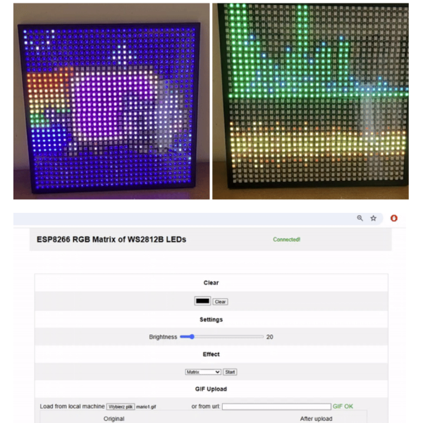

The web interface accepts GIFs for display.
[panjanek] grabbed WS2812B addressable LEDs for this project, assembling them into a 32 x 32 matrix that fits perfectly inside an off-the-shelf Ikea picture frame. The matrix is hooked up to an ESP8266 microcontroller, which acts as the brains of the operation. The WiFi-enabled microcontroller hosts its own web interface, with which the project can be controlled. Upon opening the page, it’s possible to upload a GIF file that will be displayed as an animation on the matrix itself. It’s also possible to stream UDP packets of bitmap data to the device to send real-time animations over a network.

  1. I know we’re supposed to be nice, but that pixel misalignment would drive me nuts!
    On the plus side, 8×8 ws2812 panels are insanely cheap at AliExpress – the last ones I bought were less than a dollar each. Dot pitch is about 8.2mm though.
