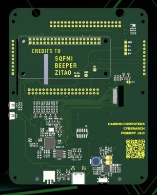

The Colorberry isn’t the only Beepy clone to keep the hardware source to itself. The PiBerry from CarbonComputers doesn’t fix the bugs from the original handheld, unfortunately, but it does bring a higher resolution color display to the party. It also doesn’t try to erase its lineage, with both the PCB silkscreen and the documentation referencing the fact that it’s based on the Beepy. Even still, the board design files aren’t included in the PiBerry repository.
What’s interesting in this case is that CarbonComputers later made a newer PiBerry version in same form-factor, aimed at assembly from more off-the-shelf components, and that version does have its KiCad files published. I’m willing to give the creators the benefit of the doubt here, and say that not including the source files for the previous versions of the hardware might simply be an omission on their part and not intentional.
