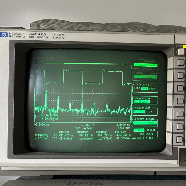

More recent instruments are computerized so taking a screen shot should be easier, but that’s still not easy if the machine can’t save to a handy disk. Along comes [Tom] with a solution, to hook up a fake printer, and grab the screen from a print.
Old instruments come with a variety of ports, serial, IEE-488, or parallel, but they should usually have the ability to print a screen. Then capturing that is a case of capturing an interpreting the print data, be it ESC/P, PCL5, Postscript, or whatever. The linked page takes us through a variety of techniques, and should be of help to anyone who’s picked up a bargain in the flea market.

GPIB is great for control, automated test and collecting data from older instruments but is way overkill if all you need is a screenshot for a document, blogpost etc. so this is a pretty cool solution (though I have a feeling I’ve seen it or something very similar elsewhere, maybe even on HaD)
This blog post is not one specifically about Fake Printer, but a more generic one about different ways in which I capture and convert test equipment screenshots.
However, in many of the methods I use Fake Printer, which is one of my earlier projects and blog posts, and one that has been featured on Hackaday as well.
If you’re interested in the pure data for visualization or post processing, GPIB is the way to go. But for my blog posts, I usually want screenshots: they look way cooler. :-)
Also, there is absolutely no standard to transfer GPIB data: for each instrument, I would need to Google or write a script. The screenshots generated by old and new test equipment are all transmitted by some know standard format. Some those, like HPCL and PostScript, are quite a pain to convert to bitmaps, but one reason why I wrote this blog post is as a notebook to myself to remember the recipes of doing so.
