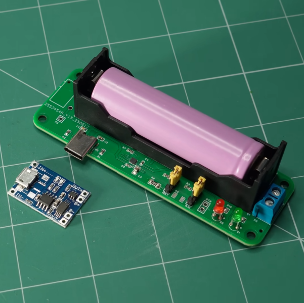

The TP4056 is the default charge-controller chip for any maker or hacker working with lithium batteries. And why not? You can get perfectly-functional knockoffs on handy breakout boards from the usual online sources for pennies. Betteridge’s Law aside, [Lefty Maker] thinks that it may well be time to move on from the TP4056 and spends his latest video telling us why, along with promoting an alternative.
His part of choice is another TI chip, the BQ25185. [Lefty] put together his own charge controller board to show off the capabilities of this chip — including variable under- and over-charge protection voltages. Much of his beef with the TP4056 has less to do with that chip than with the cheap charge modules it comes on: when he crows about the lack of mounting holes and proper USB-PD on the knock-off modules, it occurs to us he could have had those features on his board even if he’d used a TP4056.
On the other hand, the flexibility offered by the BQ25185 is great to future-proof projects in case the dominant battery chemistry changes, or you just change your mind about what sort of battery you want to use. Sure, you’d need to swap a few resistors to set new trigger voltages and charging current, but that beats starting from scratch.
[Lefty Maker] also points out some of the advantages to making your own boards rather than relying on cheap modules. Namely, you can make them however you want. From a longer USB port to indicator LEDs and a built-in battery compartment, this charging board is exactly what [Lefty Maker] wants. Given how cheap custom PCBs are these days, it’s not hard to justify rolling your own.
The same cannot be said of genuine TI silicon, however. While the BQ25185 has a few good features that [Lefty Maker] points out in the video, we’re not sure the added price is worth it. Sure, it’s only a couple bucks, but that’s more than a 300% increase!
We’ve seen other projects pushing alternative charge controllers, but for now the TP4056 reigns as the easy option.

  4. The TP4056 will only be retired when someone manages to make a jellybean switchmode charger instead.
    That turns out to be more complicated than it first seems. You pretty much need comparatively expensive off-chip passives. And how do you decide the operating frequency, manage EMI, etc. Hence why we’re all still accepting the losses of linear charging, usually from 5V. If you drop 5V down to ~2.7V at 1A you burn 2.3W with only 2.7W of the consumed 5W going to the battery, it’d be nice to do better than that.

  10. Leadless packages are a pain to solder, especially on a home made PCB with no solder mask. I will be sticking with the TP4056 since it now costs a fortune to have a PCB made.
  11. No need to swap resistors, you could just use a couple of digital potentiometers with Nvme, connected to the microcontroller so that it can more easily be adapted and this could even be used for things like adapting to an aging battery
