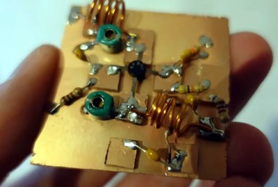

In the 90s, wire wrapping was common for prototyping so he builds a hardware digitizer interface using this method, which will be used to help the computer interface with the radio. [Old Computers Sucked] is rolling his own hardware here as well, based on a Motorola MC3362 VHF FM chip and a phase-locked loop (PLL), although this time on a PCB since RF doesn’t behave nicely with wire wrap. The PCB design is also done with software from the 90s, in this case Protel which is known today as Altium Designer.

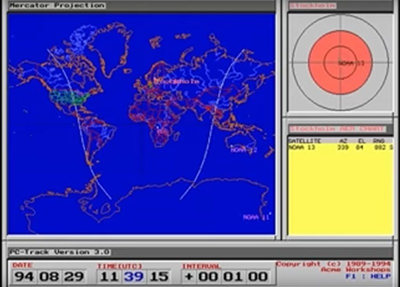

Looks like Orbitron.

Why do you show a “Manhattan” built circuit when the description talks about:”wire wrap”. Is the picture wrong or is the description?
Ummm, asking for a friend.
The Manhattan style board is a LNA featured at the end of the video. A bit confusing, but not false.
