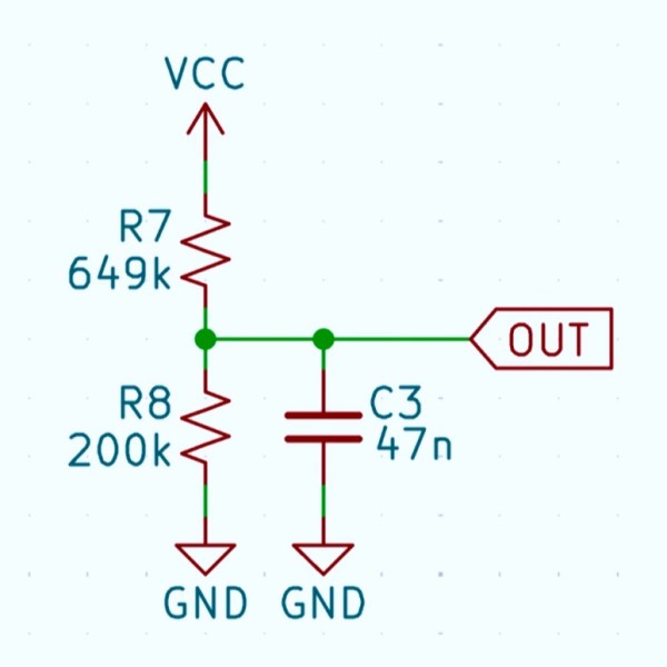

Making Actually Useful Schematics In KiCad
Schematic of a voltage divider
[Andrew Greenberg] has some specific ideas for how open-source hardware hackers could do a better job with their KiCad schematics.
In his work with students at Portland State University, [Andrew] finds his students both reading and creating KiCad schematics, and often these schematics leave a little to be desired.
To help improve the situation he’s compiling a checklist of things to be cognisant of when developing schematics in KiCad, particularly if those schematics are going to be read by others, as is the hope with open-source hardware projects.
In the video and in his checklist he runs us through some of the considerations, covering: visual design best practices; using schematic symbols rather than packages; nominating part values; specific types of circuit gotchas; Design for Test; Design for Fail; electric rule checks (ERC); manufacturer (MFR), part number (MPN), and datasheet annotations for Bill of Materials (BOM); and things to check at the end of a design iteration, including updating the date and version number.

  3. Could someone remove all the short circuits running through modern diodes.
    There is no line through the official symbols so why do so many have one nowadays?
  4. I’ve done a couple of KiCAD designs, and I’m very impressed with it. Schematic style is a whole ‘nother thing, and very much individual. The important thing is: can they be used by someone else to figure out how your circuit works and how to fix it.
  5. Sometimes these ‘schematics’ are little more than an annotated illustrated parts list. It’s easier/quicker to label a connection rather than draw it. It’s not easy to see how many parts are connected especially with the wishy washy colours used coupled to the microscopic fonts which are then stored as a bitmap.
    Draw all connections, use black on white and save as PDF.
    If you have multiple sheets, try and lay the sheets so they can be pretty much taped together to form one large sheet.
    Simple really.
    1. Thanks for mentioning that, I thought I was the only one having problem with that. If it’s an output why the wrong arrow direction. If it is an input connected to something names OUT then why is it on the right side of the schematic. Very confusing indeed, it does set the tone for the subject though.
