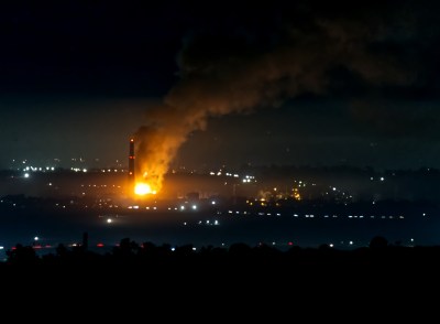

An example of such a VPP in action can be found in California, where PG&E and others have recently been running tests. A big focus here is on these home batteries, which are also used for peak-shaving in these tests, with the battery owner compensated for withdrawn power. In a report sponsored by Sunrun and Tesla Energy, the Brattle Group describes this system in which the Demand Side Grid Support (DSGS) program aspect is hailed as a major revolution.
Fire at the Moss Landing Power Plant. (Credit: Guy Churchward)
The idea here is that regular grid-connected consumers install batteries which the grid operator can then tap into, which can compensate for California’s increasing amount of non-dispatchable, non-grid forming generation sources. Of note here is that grid-scale energy storage can never provide enough capacity to bridge significant spans of time, ergo the proposal here is primarily to provide an alternative to expensive peaker plants, of which California already has a significant number.
With a predicted 4 GW of home battery capacity by 2040, this could then save the grid operators a lot of cash if they can use these batteries instead of running special peaker plants, or installing more large batteries as at the (PG&E-operated) Moss Landing battery storage facility.
Incidentally, said Moss Landing battery storage facility has repeatedly caught fire, which highlights another potentially major savings for grid operators, as the fallout of such events are instead borne by the operator of the battery, which for the DSGS would be the home owner. So far, remote adjustment of air-conditioning doesn’t seem to be a big part of the discussion yet, but this would seem to be only a matter of time, considering the significant power savings that way, even if it relies just on paid volunteers like with the DSGS.

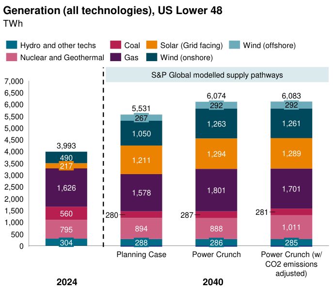

Projected electricity generation pathways by 2040. (Credit: S&P Global Inc.)
Meanwhile a recent study commissioned by the American Clean Power Association (ACP) concludes that in the US alone, electricity demand by 2040 is likely to surge 35-40% compared to today, requiring an extremely fast buildout of additional generating resources involving mostly the same kind of power mix as today. At a projected 5.5 – 6 TWh by 2024 compared to about 4 TWh today with a significant boost in non-dispatchable generators, it seems fair to question how far home batteries and a handful of V2G-enabled EV cars can support this effort in some kind of national VPP system.
