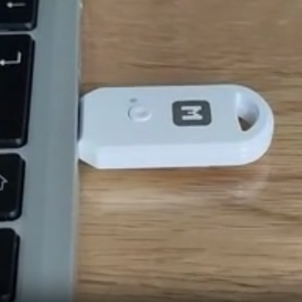

A USB dongle is shown connected to a laptop computer. A text box in the lower right corner says "PECKUS is running in DEBUG mode, it is 3x faster in non-DEBUG mode."
When we hear about flash drives in the context of cybersecurity, we tend to think of them more as threats than as targets. When you’re using flash drives to store encryption keys, however, it makes sense to pay more attention to their security. [Juergen] designed the PECKUS (Presence Enforcing Crypto-Key USB-Storage) with this specifically in mind: a few-kilobyte storage device that only unlocks if the owner’s Bluetooth device is in the vicinity.
[Juergen] needed to store an infrequently-used keyfile on an air-gapped system, and commercial encrypted flash drives were rather expensive and left much to be desired in terms of usability. Instead, he designed a CircuitPython custom firmware for MakerDiary’s nRF52840 micro development kit, which provided a BLE-capable system in the form of a USB dongle.
After flashing the firmware to the board, the user sets it up with a particular Bluetooth device and a file to be stored; after writing the file during setup, it cannot be rewritten. Before reading from the device, the user must pair the previously-set device with the board and press a button on the board, and only then does the device appear to the computer.
The limited amount of storage space means that this device will probably only serve its intended purpose, but in those cases, it’ll be handy to have an open-source and inexpensive protected storage device. [Juergen] notes that attackers could theoretically defeat this system by desoldering the microcontroller from the board and extracting the memory contents from the its storage, but if you have enemies that resourceful, you probably won’t be relying on a $20 board anyways.

  1. Adding a VL53L0x or similar motion sensor could be some extra security. You wave your hand in in some gesture to unlock it. But if it only works when a paired bluetooth device is visible, then it could also use some data from that same bluetooth device to unlock encrypted data only stored in RAM. That already makes it a lot more difficult to read out the device if it’s stolen.
    If a PC is airgapped for security reasons, I already find it strange that an USB port is accessible in the first place.
    But just the mention that circuitpython is used makes the project a dud. It’s too easy to copy such code during a toilet break, analyze & modify, and during another toilet break load a compromised software version. In my opinion there is little room for gadgetry in a security environment. If I was his boss, he’d loose all access privileges to the security sensitive part of the company. And I don’t want disgruntled employees either, so maybe immidiate firing is in order.

      1. Thing is there isnt required any cracking.
        Just plop ch340 to read the memory chip and you have key in plain text.
        If anything it gives false sense of security,

        1. From the readme on github:
          Security warning: The stock circuitpython firmware has a user-triggerable safe-mode (https://learn.adafruit.com/circuitpython-safe-mode/safemode-py), in which the application code is not run and the filesystem is exposed. If you want to use PECKUS “for real”, you should:
          Install a circuitpython firmware image that was compiled with CIRCUITPY_SAFEMODE_PY=0and CIRCUITPY_SKIP_SAFE_MODE_WAIT=1 (take a look at tools/build.sh for that)
          Disable the circuitpython console (REPL) by setting PECKUS_CONSOLE_USB to FALSE in settings.toml

      1. Did you know? A bonded BLE connection not only involves (always changing) mac addresses that are derived from the bonding key but also encryption for connection establishment (and thereafter).
        So, there is no easy BLE presence spoofing (assuming BLE firmware is implemented as per spec).
          1. The “transport” encryption is not used in PECKUS, simply because it never sends any data – connection establishment is enough for presence purposes. PECKUS does register as a (generic) input device, because Smartphones (if configured so, but it is the default) automatically do initiate those connections, so it can work without any user interaction on the smartphone during PECKUS use.

        Key is essentially written in plain text on usb devices storage chip,
        Reading that is basic hw analysis and requires 5$ readily awailable device.
        1. Yes…but this implies presence (or even possession) – the security target is to prevent (mis)use without presence.
          1. From the Readme on github:
            Security
            Foremost: PECKUS does not encrypt any data at all. It is not an encrypted USB drive, the project name implies that (most likely) a crypto-key can be stored on the device. There are three reasons why encryption has not been implemented:
            1) There is no support for (really) securely storing cryptographic key material in circuitpython. All data (inlcuding the small filesystem) is stored inside the microcontroller in non-volatile-memory (NVM), any encryption/decryption keys would therefore have to be stored “right next” to the encrypted data.
            2) Cryptographic keys need to be generated randomly/unpredictably (“entropy”), but circuitpython doesn’t provide any entropy sources.
            3) Always encrypting/decrypting data upon unlocking/relocking introduces an additional risk for failure (filesystem integrity, …)
