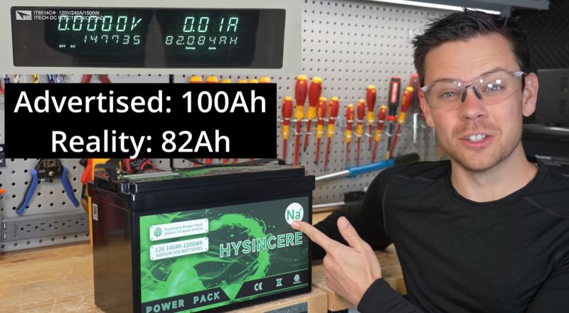

These days just about any battery storage solution connected to PV solar or similar uses LiFePO4 (LFP) batteries. The reason for this is obvious: they have a very practical charge and discharge curve that chargers and inverters love, along with a great round trip efficiency. Meanwhile some are claiming that sodium-ion (Na+) batteries would be even better, but this is not borne out by the evidence, with [Will Prowse] testing and tearing down an Na+ battery to prove the point.
The Hysincere brand battery that [Will] has on the test bench claims a nominal voltage of 12 V and a 100 Ah capacity, which all appears to be in place based on the cells found inside. The lower nominal voltage compared to LFP’s 12.8 V is only part of the picture, as can be seen in the OCV curve. Virtually all of LFP’s useful capacity is found in a very narrow voltage band, with only significant excursions when reaching around >98% or <10% of state of charge.
What this means is that with existing chargers and inverters, there is a whole chunk of the Na+ discharge curve that’s impossible to use, and chargers will refuse to charge Na+ batteries that are technically still healthy due to the low cell voltage. In numbers, this means that [Will] got a capacity of 82 Ah out of this particular 100 Ah battery, despite the battery costing twice that of a comparable LFP one.
Yet even after correcting for that, the internal resistance of these Na+ batteries appears to be significantly higher, giving a round trip efficiency of 60 – 92%, which is a far cry from the 95% to 99% of LFP. Until things change here, [Will] doesn’t see much of a future for Na+ beyond perhaps grid-level storage and as a starter battery for very cold climates.
Thanks for trying as an early adopter to Will!
But give the new battery technology a bit of slack here please!
In some months, existing chargers will be able to adapt or new chargers appearing on the market, able to handle the differences in SOC-to-V curves.
Price point for the new battery chemistry should come down also quickly when production capacity is ramped up. Especially with the much cheaper resources for sodium batteries in mind.
I am really looking forward for buying sodium batteries in the next years!
Especially for solar systems and applications where the more limited capacity/weight and/or capacity/volume relations don’t matter :)
Yeah, I see the voltage curve actually as a benefit, because it makes it much easier to determine how full a battery is. It should be a non-issue for chargers and inverters designed to support the battery type, as they all use SMPS anyway.
The internal resistance losses are an actual downside when used for higher charge/discharge current applications.
internal resistance may not be all bad, since higher internal resistance used to come with lower self discharge … if that applies here, my knowledge base about that was somewhat flattened when a dinosaur stepped on the library :(
That internal resistance thing may be both good and bad? I suppose that also means less runaway currents? But with enough in parallel this can be overcome and it’d be a non issue? My hone connection is 230V @ 30 amps, you probably want 15 or so of these when doing a 48V system anyway, so is it then still an issue?
The efficiency losses are sad though of course. I wonder if that is something chemical or something that can be improved over time…
in the Alkaline days it was about ion mobility in the separator: high ion mobility meant low resistance, but also high self discharge; low self discharge was archieved by lower ion mobility separators, at the cost of higher resistance

Man. So, first off, a test of Na battery with non-Na charger is completely valueless. But more than that, it didn’t even contemplate the only two questions that really matter: longevity (cycle count) and fire safety.
I think the practicality of Na has yet to be proven but this video is neither here nor there.
A more fair title would be “don’t use as a drop-in replacement – get a proper BMS”
