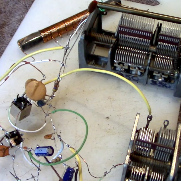

If you cultivate an interest in building radios it’s likely that you’ll at some point make a simple receiver. Perhaps a regenerative receiver, or maybe a direct conversion design, it’ll take a couple of transistors or maybe some simple building-block analogue ICs. More complex designs for analogue radios require far more devices; if you’re embarking on a superhetrodyne receiver in which an oscillator and mixer are used to generate an intermediate frequency then you know it’ll be a hefty project. [VK3YE] is here to explode that assumption, with a working AM broadcast band superhet that uses only two transistors.
The circuit diagram of the radio
It doesn’t get much simpler than this.
A modern portable radio will almost certainly use an all-in-one SDR-based chip, but in the golden age of the transistor radio the first stage of the receiver would be a single transistor that was simultaneously RF amplifier, oscillator, and mixer. The circuit in the video below does this , with a ferrite rod, the familiar red-cored oscillator coil, and a yellow-cored IF transformer filtering out the 455 kHz mixer product between oscillator and signal.
There would normally follow at least one more transistor amplifying the 455 kHz signal, but instead the next device is both a detector and an audio amplifier. Back in the day that would have been a germanium point contact diode, but now the transistor has a pair of 1N4148s in its biasing. We’re guessing this applies a DC bias to counteract the relatively high forward voltage of a silicon diode, but we could be wrong.
We like this radio for its unexpected simplicity and clever design, but also because he’s built it spiderweb-style. We never expected to see a superhet this simple, and even if you have no desire to build a radio we hope you’ll appreciate the ingenuity of using simple transistors to the max.

  6. OK, fair enough minimalist design but…
    The whole point of a superhet was to provide multiple amplification stages at a fixed frequency. This was an improvement over the earlier TRF designs that required each stage of amplification before the detector to operate at the tuned frequency, thus requiring a multi-ganged variable capacitor and careful alignment of each stage throughout the tuning range to keep the whole setup operating linearly.
    A superhet with zero IF amplification stages seems pointless – in this case a TRF receiver would be simpler, require fewer components, and have no performance penalty.

  8. Collector current is a non-linear function of base-emitter voltage – that nonlinearity enables mixing and creation of intermediate frequency. Base potential comes from received radio signal, emitter potential from local oscillator. And winding connected to collector, magnetically coupled with local oscillator’s winding, is to provide feedback so LO can work.
