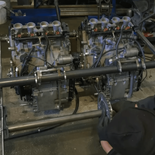

Back during WWII, Chrysler bodged five inline-6 engines together to create the powerful A57 multibank tank engine. [Maisteer] has some high-revving inline-4 motorcycle engines he’s trying to put together too, but unlike 1940s Chrysler, he also has a trombone… and a lot more RPMs to deal with.
The Chrysler flatheads were revving at a few thousand RPM– their redline was almost certainly in the three-thousand range. [Maisteer] is working at 15,000 RPM, which is where the real challenge of this build lies: the trombone in the image is just for fun. He wanted to use a heavy chain to link the crankshafts, but at that rotational speed, a heavy chain becomes really heavy— or at least, it feels a force many times its weight due to centrifugal force. The lietmotief of this video is a quote by an automotive engineer to the effect that chains don’t work over 10,000 RPM.
That leads to a few problems for the intrepid “not an engineer” that take most of the video to deal with and ultimately doom the engine linkage– for now. Not before he gets an iconic 8-cylinder sound out (plus some fire) out of a trombone, though. Of particular note is the maker-type workflow Hackaday readers will appreciate: he 3D scans the engines, CADs up parts he needs and sends away to have them CNC’d and SLS printed.

V12s are very smooth, but not perfectly balanced. You should do an H12 instead, but do a better job than Subaru did of their H12.
I6 and V12 are perfectly balanced, a H12 i not better and come with alot of other problems
In fairness it was a engine by motori moderni with Subaru’s name on
Subaru only funded it but my lord did motori make a complete hash out of that one
using two motorcycle heads to make a V8 is not so simple, one of the heads have to have the cam drive at the opposite end and that is not as simple as it sounds
Or have a cam drive at each end of the block, one for each bank.

That chain could kill somebody. What you want is a Lovejoy type coupling.
Also the power should be taken from the center not one end.
