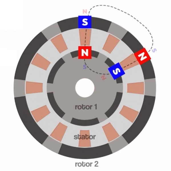

This is specifically a radial flux permanent magnet motor, like most used in electric vehicles today — and don’t let talk of inrunners and outrunners fool you, that’s the size of motor we’re talking about here. This has been done before with axial flux motors, but it’s a new concept for team radial. As the names imply, the difference is the direction the magnetic field is orientated: axial flux motors have all the magnetism oriented along the axis, which leads to the short wide profile that inspired the nickname “pancake motors”. For various reasons, you’re more likely to see those on a PCB than in an electric car.

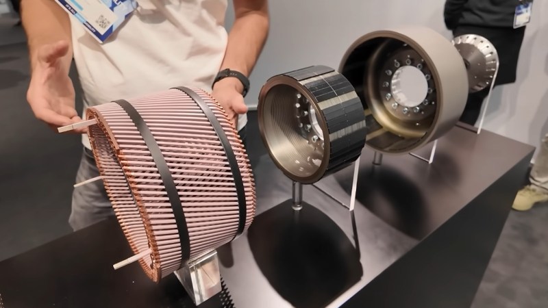

In a radial flux motor, the flux goes out the radius, so the coils and magnets are aligned around the shaft of the motor.  Usually, the coils are held by an iron armature that directs their magnetic flux inwards (or outwards) at the permanent magnets in the rotor, but not here. By deleting the metal armature from their design and putting magnets on both sides of the stator coil, Deep Drive claims to have built a motor that is lighter and provides more torque, while also being more energy-efficient.
Of course you can’t use magnet wire if your coil is self-supporting, so instead they’re using hefty chunks of copper that could moonlight as busbars. In spite of needing magnets on both inner and outer rotors, the company says they require no more rare-earths than their competitors. We’re not sure if that is true for the copper content, though. To make the torque, those windings are beefy.

    1. This is not a motor without a yoke. It took me a while to realize what’s going on here. the “dual rotor” is complete bullshit. It’s just a single rotor. The difference is that the yoke ( copper coils + laminated steel) is put in between the two cylinders of the rotor halves.
      And I do assume this has a significant effect on the motor performance, and this probably results in a higher power to weight ratio or in a higher efficiency. From what I know of motors, the design is a tradeoff between these two (and other factors such as cost).
      With a higher power density, less material is needed, which can result in a cost reduction (But offset by complexity). Overall an interesting design, I wonder how it pans out.

    2. I’m sceptical of this design. First of all, they may have rotors with magnets on both sides of the stator, which may seem like a good idea at first, but that also means they have doubled the air gap, which is detrimental.
      Secondly, the unsupported end of the stator will be pulled towards the inner and outer rotor alternatingly, at high frequency, which will easily introduce fatigue problems. Copper is a great electrical conductor, but mechanically equivalent to chewing gum.
      Thirdly, the cooling. All the heat produced in the stator must flow lengthwise through the copper for a long distance, and is then somehow transferred to the casing, while still being electrically isolated from that casing. I doubt the heat transfer is sufficient to cool the motor at high currents; this would limit the maximum current, and therefore, torque. Regular motors have sleeves around the stator, giving a much larger area for the transfer, and much shorter distance to the copper windings.
      Lastly, this thing seems very expensive to produce, especially compared to common radial flux motors. Iron is cheap, they didn’t use less copper, and I fail to see why this would require only half the magnetic material in total, considering the air gap is much bigger than in regular motors. In cost-sensitive applications (which automotive most certainly is), this will be a complete showstopper.

    Fully half of the copper mass is not in the region of the magnetic field between the rotors: The turnaround regions at the ends of the coil are outside the magnetic field area. It’s dead weight and doubles the ohmic loss.
