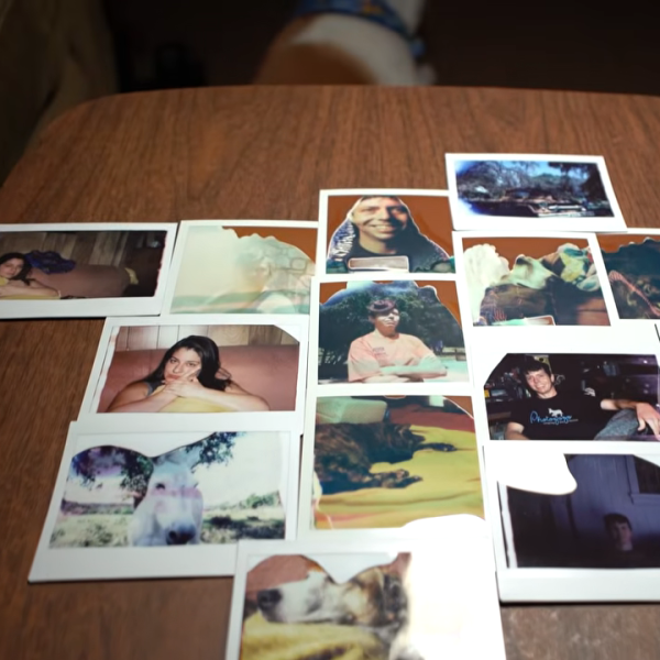

You can’t just slam an Instax cassette in an old Polaroid camera and expect it to work. The films are completely different sizes, and there’s no way they will feed properly through the camera’s mechanisms at all. Instead, you have to get manual about things. [Nick] starts by explaining the process of removing Instax film sheets from a cassette, which must be done without exposure to light if you want the film to remain useful. Then, if you know what you’re doing, you can tape it in place behind the lens of an old-school Polaroid camera, and expose it as you would any other shot. The chemistry is close enough that you’ll have a fair chance of getting something with passable exposure.
Once exposed, you have to develop the film. Normally, a Polaroid camera achieves this by squeezing the film sheet out through rollers to release the developer and start the process. Without being able to rely on the camera’s autofeed system, you need to find an alternative way to squeeze out the chemicals and get the image to develop. [Nick] recommends a simple kitchen rolling pin, while noting that you might struggle with some uneven chemical spread across the sheet. Ultimately, it’s a fussy hack, but it does work. It might only be worthwhile if you’ve got lots of Instax film kicking around and no other way to shoot it.

  3. Unless you were using a Polaroid camera designed for the earlier peel apart film or for that matter, a medium or large format, regular film camera, the Instax image will be a reversed, i.e. mirror image with backwards text, etc.
    This is because Polaroid SX 70 film is exposed through the front, but Fuji Instax film is exposed through the back.
    I would think you would get better results with less hassle from a roll film camera. A sheet film camera would be even easier.
