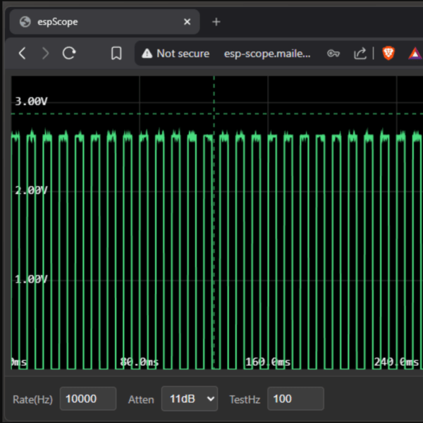

A browser window is shown, in which a web page is displaying a green trace of a square wave.
An oscilloscope is usually the most sensitive, and arguably most versatile, tool on a hacker’s workbench, often taking billions of samples per second to produce an accurate and informative representation of a signal. This vast processing power, however, often goes well beyond the needs of the signals in question, at which point it makes sense to use a less powerful and expensive device, such as [MatAtBread]’s ESP32 oscilloscope.
The oscilloscope in its housing.
The oscilloscope doesn’t have a display; instead, it hosts a webpage that displays the signal trace and provides the interface. Since the software uses direct memory access to continually read a signal from the ADC, it’s easy to adjust the sampling rate up to the hardware’s limit of 83,333 Hz. In addition to sampling-rate adjustment options, the browser interface includes a crosshair pointer for easy voltage reading, an adjustable trigger level, attenuation controls, and the ability to set the test signal frequency. The oscilloscope’s hardware is simply a Seeed Studio Xiao development board mounted inside a 3D-printed case with an AA battery holder and three pin breakouts for ground, signal input, and the test signal output.
This isn’t the first ESP32-based oscilloscope we’ve seen, though it is the fastest. If you’re looking for a screen with your simple oscilloscope, we’ve seen them built with an STM32 and Arduino. To improve performance, you might add an anti-aliasing filter.

  3. I’m not sure what ESP32 that is (original, S3, C3, whatever) but the original one had a hardware limit of around 2 MSPS. I made a project a while ago that reached those speeds, but it involved writing to a bunch of horribly documented registers because the IDF functions never got that fast.
    1. It’s an esp32c6 I had lying around. I know some of the others theoretically have higher sample rates, but you’d probably hit other bottlenecks before you got to 2MSPS
      1. I’m telling you I have a project working at 2MSPS, lol.
        I made an LCR meter that measures pretty reliably up to 500 KHz (2 channels, 1MSPS per channel, 500KHz Nyquist, FFT measurement). It still lacks a few calibrations, but I can tell you it’s totally feasible. But there are a ton of firmware quirks
    2. There are much better options if you can just use an additional wifi chip. There are STM32 parts that can reach 5 MSPS properly with DMA and even achieve higher rates with interleaving and they support scanning multiple inputs in sequence. The limit of 83 kHz really doesn’t seem great here.
      1. If you’re replying to me, then the limit is actually 2 MSPS, as I stated. An STM32 will have a better and faster ADC, but at least for my specific project, the ESP32:

    1. On the esp32c6, no. There is a second ADC, but it’s not accessible whilst WiFi is running, which it obviously is since it’s serving a webpage.
      I think some of the other esp32 devices might have more available, but I think you might ruin into other bottlenecks at to speed
        1. Looks cool. TBH, I just needed something quick with the hardware I had lying around, and I wanted to test out Antigravity. It’s not the most sophisticated ‘scope ever made (but I might be the cheapest – you get change from £6)
  4. You could pair it with an ATTINY427 and get ~156Khz but with a 5V 12 bit ADC that is far better than the built in ESP32. you could oversample and get 13 bits and still have ~156khz which is the limitation of the SPI/UART.
