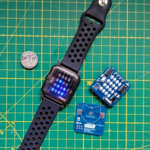

Over the decades we have seen many DIY clocks and wrist watches presented, but few are as likely to get you either drawing in the crowds, or quietly snickered at behind your back, as a binary watch of some description does. A wrist watch like [qewer]’s qron0b project which also uses BCD encoding to display the current time is among our more rare project types here, with us having to go all the way back to 2018 for a similar project as well as a BCD desk clock.
As is typical, a single CR2032 coin cell powers the entire PCB, with an ATtiny24A or compatible as the MCU, a DS1302 RTC and the requisite 4×4 LED matrix to display the hours and minutes. Technically three LEDs are unneeded here, but it looks nicely symmetrical this way, and the extra LEDs can be used for other tasks as the firmware is expanded from the current setting and reading of the time.
The AVR C firmware can be found in the above linked GitHub repository, along with the KiCad PCB project and FreeCAD design files for the watch body. The body accepts a 22 mm GT2/GT3-style watch strap to complete the assembly. With a single CR2032 you’re assured of at least a few months of runtime.

    1. Hey! Project creator here.
      In the firmware, for main timekeeping tasks while the watch is awake, a global “uptime” variable that gets updated from the TIM2 ISR (TIM2 is configured to tick every 1ms) is used. delay_ms and delay_us are used mainly for either simple animations or communication delays. The watch uses around 1mA in awake mode (in sleep it’s around 30uA), it wakes up only when you press the button and sleeps 10 seconds later. With those calculations and my own usage experience, it should last around at least 7-8 months from a single CR2032 cell.

  2. This is a terrible design for those reasons:
    Blue LEDs are a terrible match for a CR2032 coin cell. The cell voltage will quickly drop beyond the useful range to light the LEDs.
    the spaghetti code with delay loops is terribly inefficient. Gosh. there are efficient libraries using timers around.
    DS1307 , a 80s era RTC chip uses something like 1200x more current for keeping time than for example PCF8563, and has twice more drift.
    the shift register is useless: 5 pins are enough to charlieplex the 4×4 matrix, and would use less energy, since that chip is ALWAYS enabled (/OE tied to ground)
    And the schematic… oh no, please. what´s the point to butcher it in 4 parts for such a simple circuit ?
    and what´s this PWR_FLAG label that is connected both on the power rail and the ground ?
    “With a single CR2032 you’re assured of at least a few months of runtime” gratuitous, very unlikely, unverified HaD-style assumption.
      Thanks for the feedback. It’s quite literally my first ever time designing anything low-power (and as mentioned in the Github README) there are a few small design issues. But to address your points:
      Blue LEDs are just for aesthetic reasons, they can be replaced with green or red. The cell voltage does NOT drop “beyond the useful range” since the watch uses 1.5mA max while awake. A CR2032 can easily supply that for a short period (the watch is awake for 10 seconds typically).
      My code already uses timers, delays are used mainly for either simple animations or communication delays. Could definitely have some improvements there but if you actually read the code, you’ll see it’s far from spaghetti.
      I used a DS1302 for ease-of-access but yeah a PCF8563 would definitely be a better choice. Same with the shift register, it’s not strictly needed. They can definitely be improved, as I said, this is my first time designing anything low-power and I’m a student.
      A PWR_FLAG label is a KiCAD specific thing to avoid ERC errors. Basically it tells KiCAD that those power nets are driven externally.
      Power usage is NOT a mere “assumption”. The watch uses around 1mA (+- 0.5 depending on what it’s doing and how many LEDs are on) while awake and around 30uA in sleep. If you do the math, with a CR2032’s 250mAH capacity, you get around 11 months (and if we include the awake times, you’ll still get 6+ months easily). It’s been going strong for more than a month since I’ve made it and the battery has barely depleted, closely matching the calculations.
