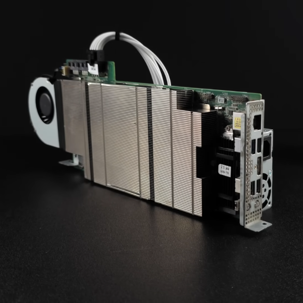

For various reasons, crypto mining has fallen to the wayside in recent years. Partially because it was never useful other than as a speculative investment and partially because other speculative investments have been more popular lately, there are all kinds of old mining hardware available at bargain prices. One of those is the Asrock AMD BC250, which is essentially a cut down Playstation 5 but which has almost everything built into it that a gaming PC would need to run Steam, and [ETA PRIME] shows us how to get this system set up.
The first steps are to provide the computer with power, an SSD, and a fan for cooling. It’s meant to be in a server rack so this part at least is pretty straightforward. After getting it powered up there are a few changes to make in the BIOS, mostly related to memory management. [ETA PRIME] is uzing Bazzite as an operating system which helps to get games up and running easily. It plays modern games and even AAA titles at respectable resolutions and framerates almost out-of-the-box, which perhaps shouldn’t be surprising since this APU has a six-core Zen 2 processor with a fairly powerful RDNA2 graphics card, all on one board.
It’s worth noting that this build is a few weeks old now, and the video has gotten popular enough that the BC250 cards that [ETA PRIME] was able to find for $100 are reported to be much more expensive now. Still, though, even at double or triple the price this might still be an attractive price point for a self-contained, fun, small computer that lets you game relatively easily and resembles the Steam Machine in concept. There are plenty of other builds based on old mining hardware as well, so don’t limit yourself to this one popular piece of hardware. This old mining rig, for example, made an excellent media server.

    1. These are built around the integrated CPU/GPU that AMD designed and TSMC manufactured for the Playstation 5, but with a quarter of the compute units disabled (24 instead of 32).
      So no, nobody pilfered the guts out of PS5s to make these, but they’re perhaps the only other system built around this custom APU.
      I don’t know if it’s true, but a common assumption is that these were (at least initially) PS5 APUs that didn’t pass QA for their intended market after the testing and binning process, but still performed acceptably with some of their compute units fused off.
      In any case, asrock saw an opportunity to build blade servers for mining out of ’em.
        1. Yep, and those were also presumed to be PS5 cast-offs by Tom’s Hardware and others.
          The BC250 from this article more or less identifies itself as a 4700s, CPU-wise – all of them really do seem to be the same APU with different bits disabled.

            While I wouldn’t suggest that the setup demonstrated in the video – flashing a bios update, installing a recent version of a linux distribution like Bazzite, and changing a few kernel boot settings- is trivial, that’s really all you need to do to get something that runs all the games that’ll work on a steam deck (but with a much better GPU) or anything else that’ll run on linux (or in a VM within linux).
            And yet it’s simultaneously also true that you’re not getting “what the hardware could do if someone cared to optimize for it” – when it comes to games that run on both systems, this thing isn’t remotely close to 3/4 of a PS5.
            Personally, I still think this is a fabulous little system for the money if you understand its significant limitations (some of which other commenters have touched on, like idle power draw) and have a sensible use case.
