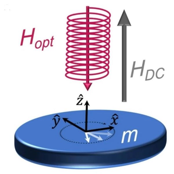

As an electromagnetic radiation phenomenon, it’s perhaps not so surprising that light is affected by a magnetic field. This Faraday effect (FE) has been used since its discovery by [Michael Faraday] in 1845 for a wide range of applications, allowing for the manipulation of light’s polarization, something which is very useful in the field of optics, for remote sensing and spintronics. Despite this being such a well-known property of EM radiation a recent study claims to have made a new discovery here, with what they claim is about the ‘optical magnetic field’.
Their central claim is that it is not just the electrical component that contributes to the FE, but also the magnetic one, due to Zeeman energy that expresses itself from the magnetic component as a form of inverse FE. Based on their experimental findings they estimate that it contributes to the final measured FE by about 17% at a wavelength of 800 nm.

      1. The “Missing” Magnetic Contribution
        Old Knowledge: Since Michael Faraday’s discovery, it was assumed that the rotation of light’s polarization (the Faraday Effect) was caused by the electric field of light interacting with the electric charges (electrons) in a material. The magnetic component of the light wave was considered too weak to have any measurable impact.
        The New Discovery: Researchers at the Hebrew University of Jerusalem showed that the oscillating magnetic field of light actually exerts a “magnetic torque” on the atomic spins within a material. This is not a negligible side effect; it is a “first-order” effect that directly causes polarization rotation.
        Why This Matters
        This isn’t just a theoretical correction; it has practical implications for future technology:
        Spintronics & Memory: Understanding that light can “talk” to matter magnetically allows for more precise control over magnetic memory and data storage using light.
        Quantum Computing: It provides a new mechanism for controlling “spins” (the basis for many qubits) using optical pulses.
        Optical Engineering: Engineers designing sensors or isolators (which prevent light from back-reflecting in lasers) now have a more accurate “blueprint” for how materials will behave, especially in the infrared spectrum used in telecommunications.
        In short, the paper proves that light doesn’t just illuminate matter; it magnetically influences it in a way we’ve been ignoring for nearly two centuries
