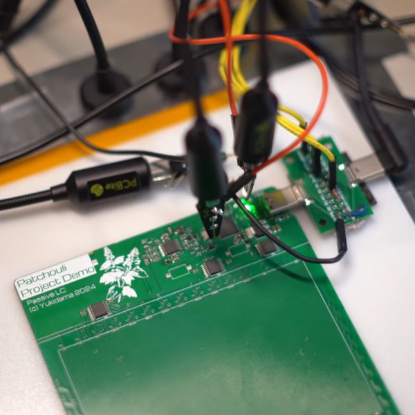

Drawing tablets have been a favorite computer peripheral of artists since its inception in the 1980s. If you have ever used a drawing tablet of this nature, you may have wondered, how it works, and if you can make one. Well, wonder no longer as [Yukidama] has demonstrated an open source electromagnetic resonance (EMR) drawing tablet build!
The principle of simple EMR tablets is quite straight forward. A coil in the tablet oscillates from around 400 kHz to 600 kHz. This induces a current inside a coil within the pen at its resonant frequency. This in turn, results in a voltage spike within the tablet around the pen’s resonant frequency. For pressure sensing, a simple circuit within the pen can shift its resonant frequency, which likewise is picked up within the tablet. The tablet’s input buttons work in similar ways!
But this is merely one dimensional. To sample two dimensions, two arrays of coils are needed. One to sample the horizontal axis, and one the vertical. The driver circuit simply sweeps over the array and samples every coil at any arbitrary speed the driver can achieve.
Finally, [Yukidama] made a last demo by refining the driver board, designed to drive a flexible circuit containing the coils. This then sits behind the screen of a Panasonic RZ series laptop, turning the device into a rather effective drawing tablet!

        1. Induction exists, but EMR systems are explicitly designed so that only deliberately driven, frequency-locked magnetic fields matter. Everything else is noise by design.
          Yes, moving a magnet near a coil induces some voltage. That’s not in dispute. The problem is magnitude, coherence, coupling, and synchronization.
          EMR tablets actively drive known AC fields and use tuned resonance plus synchronous detection to extract pen position. Random, hand-moved magnetic fields are weak, broadband, unsynchronized, and get filtered out — otherwise power lines, speakers, and Earth’s field would constantly trigger false input.
          Physics allows induction; engineering decides what survives the filters.
        2. “So ac generators are impossible then because moving a magnetic field around a conductor can’t possibly produce a voltage and current in said conductor”
          Have an AI explain the article to you. The detection oscillators are tuned 400-600KHz.
          If you can wiggle your magnet back and forth 400,000 times a second, then you’ve got yourself some interference.
