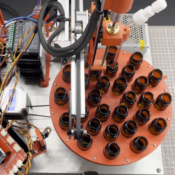

A common task in a laboratory setting is that of sampling, where a bit of e.g. liquid has to be sampled from a series of containers. Doing this by hand is possible, but tedious, ergo an autosampler can save a lot of time and tedium. Being not incredibly complex devices that have a lot in common with e.g. FDM 3D printers and CNC machines, it makes perfect sense to build one yourself, as [Markus Bindhammer] of Marb’s Lab on YouTube has done.
The specific design that [Markus] went for uses a sample carousel that can hold up to 30 bottles of 20 mL each. An ATmega-based board forms the brain of the machine, which can operate either independently or be controlled via I2C or serial. The axes and carousel are controlled by three stepper motors, each of which is driven by a TB6600 microstep driver.

  1. Markus always has one or two parts to a build that genuinely impress me. This one it’s the PCB work. Beautiful hobby board.
    Great project too. I could fall asleep to the sounds of autosamplers. I wonder what this will feed?
  2. Neat! But why use a C-Y-Z axis machine instead of an X-Y-Z axis machine?
    Also, the narrator has exactly the same voice as Henry Kissinger.
  3. If I’m not mistaken this arrangement allows for a lot more “work area” while introducing less travel along linear axles, therefore being easier to get more stable. I know that’s the reason some 3d printers attempted it, but there the dead zone in the center is an issue. Here it isn’t.
