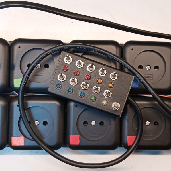

Who among us does not have a plethora of mains-powered devices on their workbench, and a consequent mess of power strips to run them all? [Jeroen Brinkman] made his more controllable with a multi-way switch box.
At first sight it’s a bank of toggle switches, one for each socket. But this is far more than a wiring job, because of course there are a couple of microcontrollers involved, and each of those switches ultimately controls a relay. There are also status LEDs for each socket, and a master switch to bring them all down. Arduino code is provided, so you can build one too if you want to.
We like the idea of a handy power strip controller, and especially the master switch with the inherent state memory provided by the switches. This could find a home on a Hackaday bench, and we suspect on many others too. It’s by no means the first power strip with brains we’ve seen, but most others have been aimed at the home instead.

    1. The person who made this has the most Dutch name ever. So that would be a TN-C-S system if he’s indeed Dutch.
      This is the first time I heard of CIS countries. Eurasian union. Interesting.
      1. Oh now it rings a bell – it looked like i saw these sockets somewhere, but was’t able to remember where. Because they are black. In Russia, if this type is used, it is almost always made from off white brittle plastic – like this one https://www.etsy.com/listing/862968067/vintage-ussr-electric-outlet-retro-white
        There were (still are) also appliances with plugs from same off white plastic – but instead of just flat two prongs as we know from Europe (Europlug), they had round flange. And no hole for grounding pin (GOST 7396 C1 – https://en.wikipedia.org/wiki/GOST_7396#/media/File:Soviet_Plug_Type1_6A_250V.jpg) . So they can somehow be forced into shuko but not type E.
        1. We had the same plugs with the same brittle plastic in the Netherlands. I’ve used saws and files to cut the holes for the ground plugs in the sides of the round connectors because the round connects did not have any cutouts for grounding pins. I have outlets in my house that are also just round with no grounding pins, and are made from Bakelite.
          So I guess the old Dutch and USSR electrical outlets and plugs are the same or at least very similar

    1. It looks like the microcontroller is just used to reduce the number of wires in the control cable. Connecting the switches directly would have needed a cable with 11 conductors.
