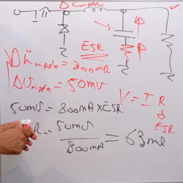

[Dr Ali Shirsavar] from Biricha Digital runs us through How to Select the Perfect Output Capacitor for Your Power Supply. Your switching-mode power supply (SMPS) will require an output capacitor both to iron out voltage swings due to loading and to attenuate ripple caused by switching. In this video we learn how to calculate the required capacitance, and when necessary the ESR, for your output capacitor.
To begin [Dr Ali] shows us that in order to calculate the minimum capacitance to mitigate voltage swings we need values for Δi, Δv, and Ts. Using these we can calculate the minimum output capacitance. We then need to calculate another minimum capacitance for our circuit given that we need to attenuate ripple. To calculate this second minimum we need to change our approach depending on the type of capacitor we are using, such as ceramic, or electrolytic, or something else.
When our circuit calls for an electrolytic capacitor the equivalent series resistance (ESR) becomes relevant and we need to take it into account. The ESR is so predominant that in our calculations for the minimum capacitance to mitigate ripple we can ignore the capacitance and use the ESR only as it is the feature which dominates. [Dr Ali] goes into detail for both examples using ceramic capacitors and electrolytic capacitors. Armed with the minimum capacitance (in Farads) and maximum ESR (in Ohms) you can then go shopping to find a capacitor which meets the requirements.

  3. Use low loas MLCCs with a self resonate frequency as close to your switching frequency for your bulk capacitance. Then you want a small physically sized (but high in capacitance) NPO class cap with the shortest return path you can get from the switch output to ground. This small cap keeps the loop inductance low and reduces switching noise spikes.
    Layout of switch mode power supplies is very important. One that is laid out right will be efficient, have a low ripple output, and emit little EMI noise.

  4. The video explains how to calculate the minimum required capacitance and the maximum ESR (for electrolytic cap) for the output capacitor. But are there any maximum capacitance and minimum ESR not to overcome, and if so, what are the possibly bad consequences?
    If not, it would mean that taking a very big capacitance, in the best series of capacitor available (very low ESR, high temperature, long life) would be at the same time the most efficient (very low dip and very low ripple) and long term reliable solution. Of course mass manufacturers would not go this way to minimize cost and maximize profits, but as individuals we could certainly afford to replace a few capacitors in our SMPS to upgrade them.
    1. i´m no expert but i´ve come across cheap converters that don´t like huge capacitive loads, some high quality dc-dc converters explicitely tell you in the datasheet not to connect to a certain and greather tan X capacitante at the output, i guess because the Control loop of the converter would register a error since he can´t get the output voltage to the desired leven in a certain time so it registers that as a failure scenario.
      other than that, if you are designing your supply, i guesse the merrier the better but there are practical limits, also, when you connect your power supply to a load, the energy stored in the caps will dump fast in the load, at my company, one client asked us to build a extremely low output capacitante power supply, the unit supplies 300A at 40V with a ripple ridiculously low and PPM precision levels ( particle accelerator magnet supplies) so it can be done, but oh boy, at what cost.
    2. Minimum ESR depends on control compensation.
      Voltage-mode controllers generally require controlled ESR, to insert a zero in the transfer function, pulling back any possible phase margin from the LC filter. Even so, controller cutoff frequency is near or below LC cutoff. Ye olde ATX PSU had a forward converter with voltage-mode control (TL494 et al), and might run at Fsw = 40kHz, LC cutoff of a few kHz, and so the capacitance required is quite large (~10mF).
      Current-mode controllers can operate above the LC cutoff, so don’t need as much capacitance for the same output impedance, and offers better PSRR. Compensation can accommodate ESR down to zero, making ceramics practical.
      Anything with a control loop is applicable. Always check linear regulators for C/ESR range (and ADJ/GND pin current in dropout, another easy gotcha). They tend to omit it these days as “ceramic stable” types have been available for a while, but actual data is exponentially better than some nod in the marketing headline.
      Polymer electrolytics tend to have very low ESR, though they’re available in a range. They’re very similar to film caps actually, but for proportionally lower voltages (you’re hard pressed to find films below 100 or 50V, and in values more than a few µF) and higher capacitances. This is good for ripple current handling, but means you don’t want to simply replace electrolytics with them; the low ESR further encourages series resonances in the PDN (power distribution network), between trace inductance and other low-ESR (ceramic) bypasses.
      Maximum capacitance tends to be due to startup conditions; a hiccup-mode protection for example might not achieve stable output voltage if the output is loaded with too much capacitance. Maybe it catches on the next pulse or two, but if the load is heavy or starts up after one pulse, discharging that capacitance inbetween, well, it’s just gonna sit there ticking away forever.
