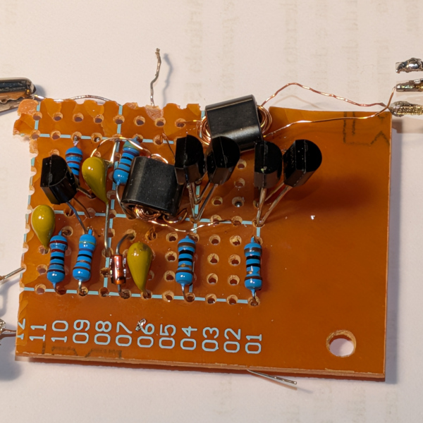

When building a radio transmitter, unless it’s a very small one indeed, there’s a need for an amplifier before the antenna. This is usually referred to as the power amplifier, or PA. How big your PA is depends on your idea of power, but at the lower end of the power scale a PA can be quite modest. QRP, as lowe power radio is referred to, has a transmit power in the miliwatts or single figure watts. [Guido] is here with a QRP PA that delivers about a watt from 1 to 30 MHz, is made from readily available parts, and costs very little.
Inspired by a circuit from [Harry Lythall], the prototype is built on a piece of stripboard. It’s getting away with using those cheap transistors without heatsinking because it’s a class C design. In other words, it’s in no way linear; instead it’s efficient, but creates harmonics and can’t be used for all modes of transmission. This PA will need a low-pass filter to avoid spraying the airwaves with spurious emissions, and on the bands it’s designed for, is for CW, or Morse, only.

  3. The circuit this design is based on, is apparently a linear amplifier according to the original creator Harry Lythall.
    The output of Guido’s amplifier has a lot of harmonics. That’s to be expected if the input is connected to a source which has a lot of harmonics, such as the output of an SI5153.
    I’m no expert in power amplifiers, but that schematic doesn’t look like a class C amplifier to me.
    Personal taste: the signal ground should be along the bottom edge of the schematic, not halfway around the schematic.

    Instead of using a strip board it may be better to use a RF box with air-wiring or Manhattan style so components are spaced out in 3D. This reduces stray capacitance between traces that you’d normally get on a PCB. At high frequencies, a PCB trace can accidentally act like a capacitor or an antenna, “leaking” the signal where it shouldn’t go
