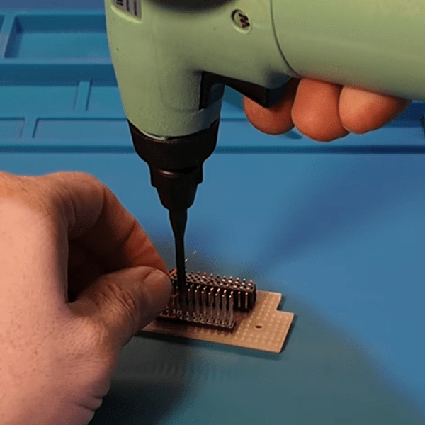

Before PCBs, wiring electronic circuits was a major challenge in electronics production. A skilled person could make beautiful wire connections between terminal strips and components with a soldering iron, but it was labor-intensive and expensive. One answer that was very popular was wire wrapping, and [Sawdust & Circuits] shows off an old-fashioned wire wrap gun in the video below.
The idea was to use a spinning tool to tightly wrap solid wire on square pins. A proper wrap was a stable alternative to soldering. It required less skill, no heat, and was easy to unwrap (using a different tool) if you changed your mind. The tech started out as wiring telephone switchboards but quickly spread.
Not all tools were guns or electric. Some used a mechanical handle, and others were like pencils — you simply rotated them by hand. You could specify levels for sockets and terminals to get a certain pin length. A three-level pin could accept three wire wrap connections on a single pin, for example. There were also automated machines that could mass-produce wire-wrapped circuits.
The wire often had thin insulation, and tools usually had a slot made to strip the insulation on the tiny wires. Some guns created a “modified wrap” that left insulation at the top one or two wraps to relieve stress on the wire as it exited the post. If you can find the right tools, wires, and sockets, this is still a viable way to make circuits.

    1. I tried it back in the day – 30-40 years ago, trying to make an S-100 multi-EPROM board. If I recall, the biggest drawback was the special insulation on the wire, regular PVC wire-wrap wire did not work. Also, the tool was battery-powered, and nothing like the AC-powered wire-wrap guns.
  2. The post was square. This produces a small air tight nick in the wire at each corner and each wrap. When done correctly, t is very low resistance and, being air tight in the nick, not prone to oxidation.
    If not carefully wrapped, there can be a one or more wraps with the kynar insulation around the post. As rise times increased this became an issue, along with the general capacitance and inductance of the wires laying side by side and crisscrossing around the board.
    As noted there were machines that could mass produce large boards with thousands of wraps. These machines were at one point based on the PDP-8 and was the reason the PDP series was produced in quantities that were not surpassed until the IBM PC was introduced.

  6. The “squeeze” wrap guns are good for one-off wraps, but your hand will protest after more than one or two. Gun or wrap/unwrap tool worked best for me. I still have an elecric wrap tool. Built a lot of projects with it and they worked reliably.
  7. “left insulation at the top one or two wraps” should be bottom one or two wraps, the stripped tail is wrapped last. Doing it the other way would require some sort of Rick Sanchez inter-dimensional W/W Gun.
