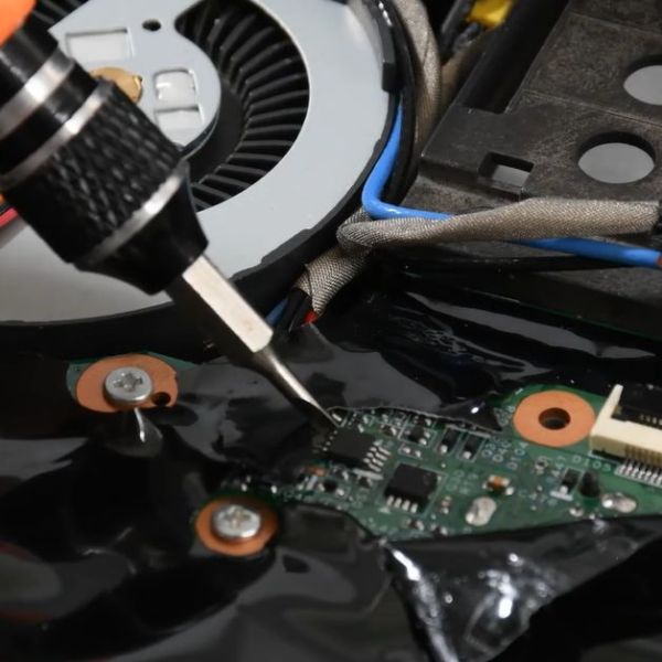

In the olden days, an administrator password on a BIOS was a mere annoyance, one quickly remedied by powering off the system and pulling its CMOS battery or moving a jumper around. These days, you’re more likely to find a separate EEPROM on the mainboard that preserves the password. This, too, is mostly just another annoyance, as [onionboots] knew. All it takes is shorting out this EEPROM at the right time to knock it offline, with the ‘right time’ turning out to be rather crucial.
While refurbishing this laptop for a customer, he thought it’d be easy: the guide he found said he just had to disassemble the laptop to gain access to this chip, then short out its reset pin at the right time to make it drop offline and keep it shorted. Important here is that you do not short it when you are still booting the system, or it won’t boot. This makes for some interesting prodding of tiny pins with a metal tool.
What baffled him was that although this method worked, and he could now disable the password, on the next boot, it would be enabled again. As it turns out, to actually save the new supervisor password status to the EEPROM, you should stop shorting its pin, else you cannot write to it. Although the guide said to keep shorting it, this was, in hindsight, a clear case of relying too much on instructions and less on an obvious deduction. Not like any of us are ever guilty of such an embarrassing glitch, natch.
At any rate, it was still infinitely faster than trying to crack such a password with a brute-force method, even if helped by an LLM.

  1. You can buy an SOIC test clip for a few dollars. Then you can just connect a switch to the reset pin instead of having to poke it with a screwdriver. A couple of test leads with micro grabbers would work too.
    1. Yeah, he made the task a bit more complicated than necessary. On another note: I wonder why the password can be written back to the EEPROM by letting go of the “short”. I would think a not initialized EEPROM (that stores a password!) at startup would be flagged as such by the BIOS and a mere “here, the EEPROM is available again” should not work.
      1. All commands for read and write are self contained. The cpu can’t tell, if the software is poorly written, that the rom answered FF’s, or maybe ignores that case as a new board.

      3. I wonder if the flag would be stored on the same chip? I don’t expect a BIOS to have too many kinds of writeable persistent memory available.
    1. Assuming its not encrypted, which is possible but dumb. Laptops can contain data worth thousands and even millions of dollars in the wrong hands.
